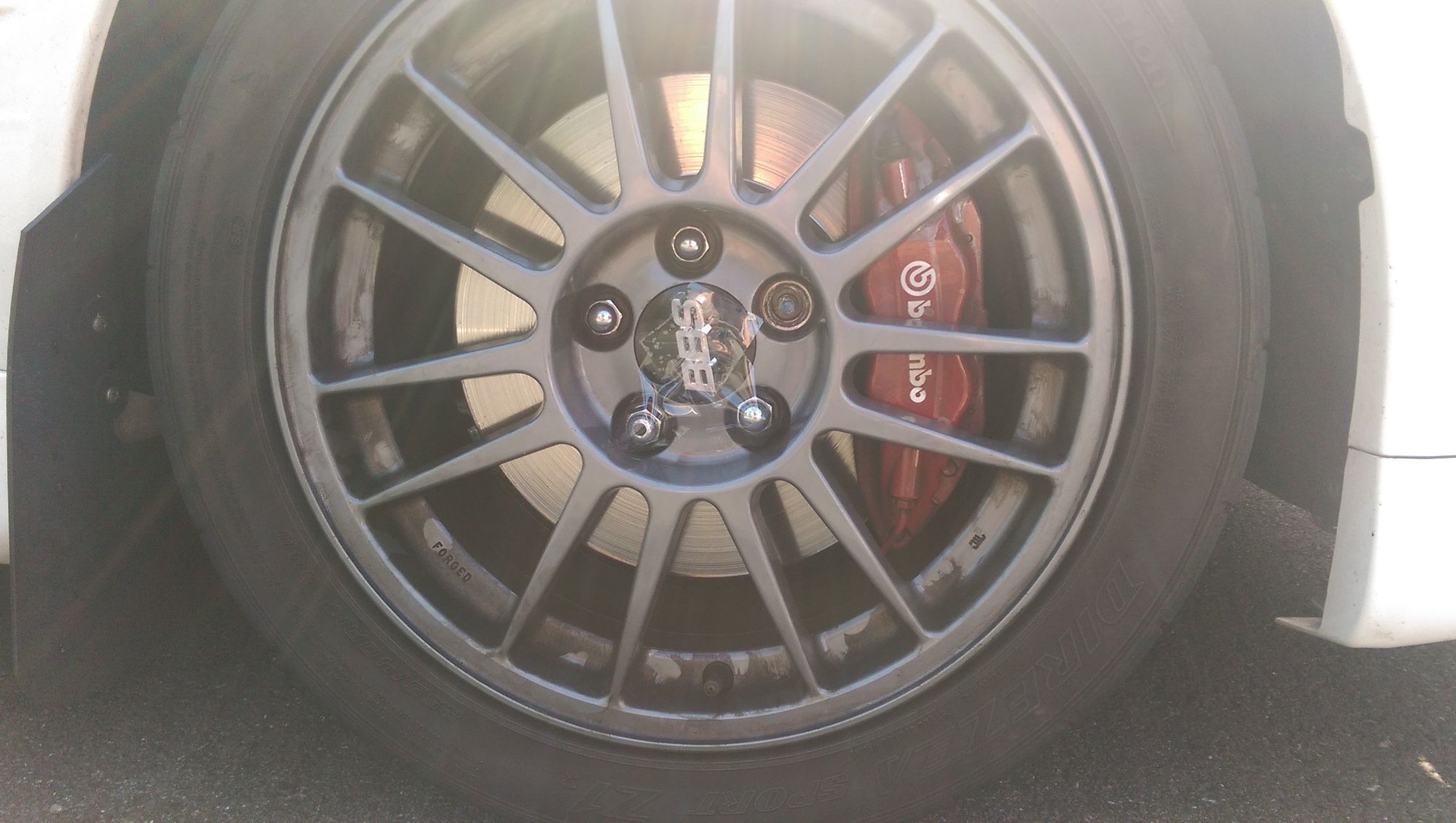

So $285, 5 new studs and 5 new lugs later, this is the state of my wheel...
This is what it started out like:
They ended up having to use a torch.
I expected more from professionals..
I didn't ask, but I don't understand why they didn't drill it out..
The shop that did this:
Caliber Tire And Auto Service
174 S Main St, New City, NY 10956

I wouldn't run that wheel. Aluminum doesn't play well with heat (torches)...
