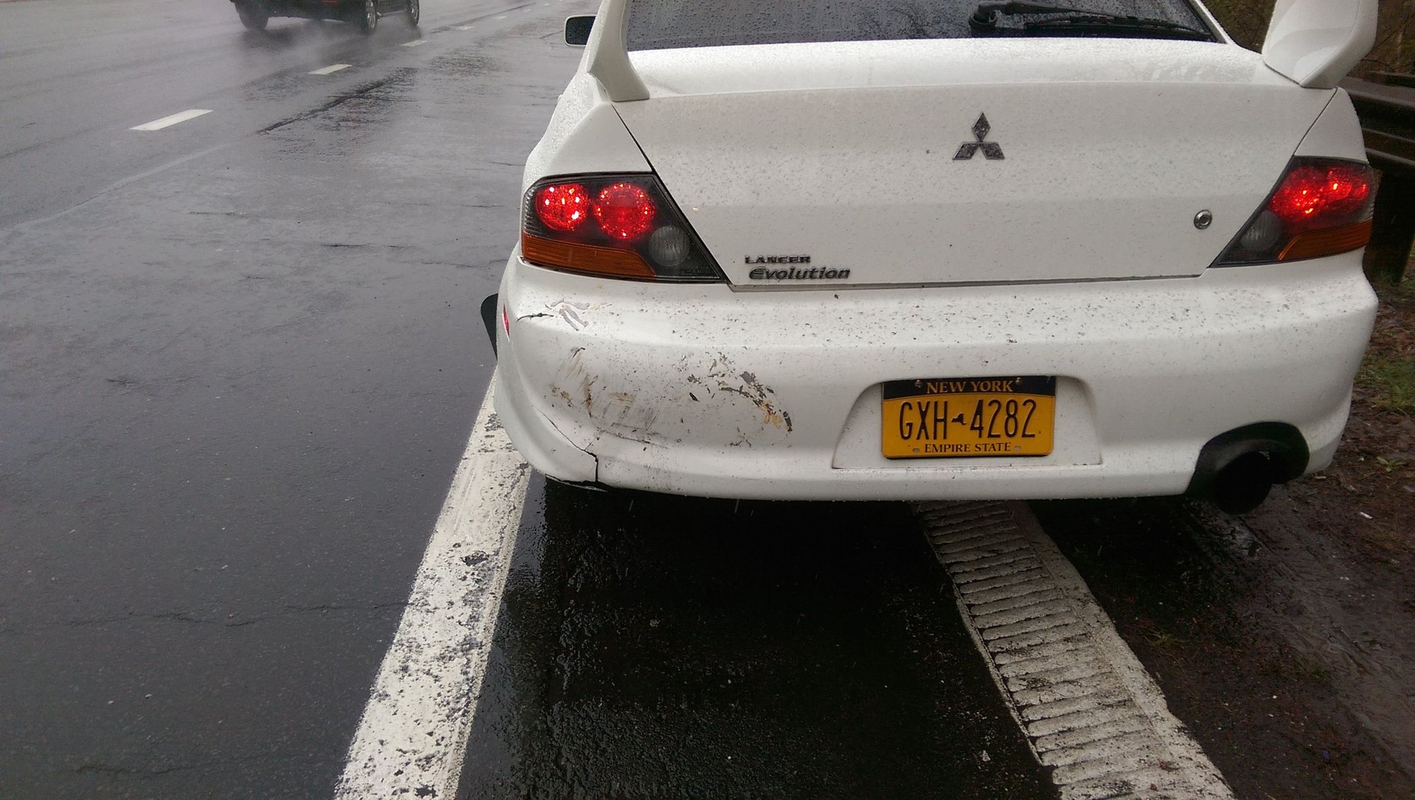

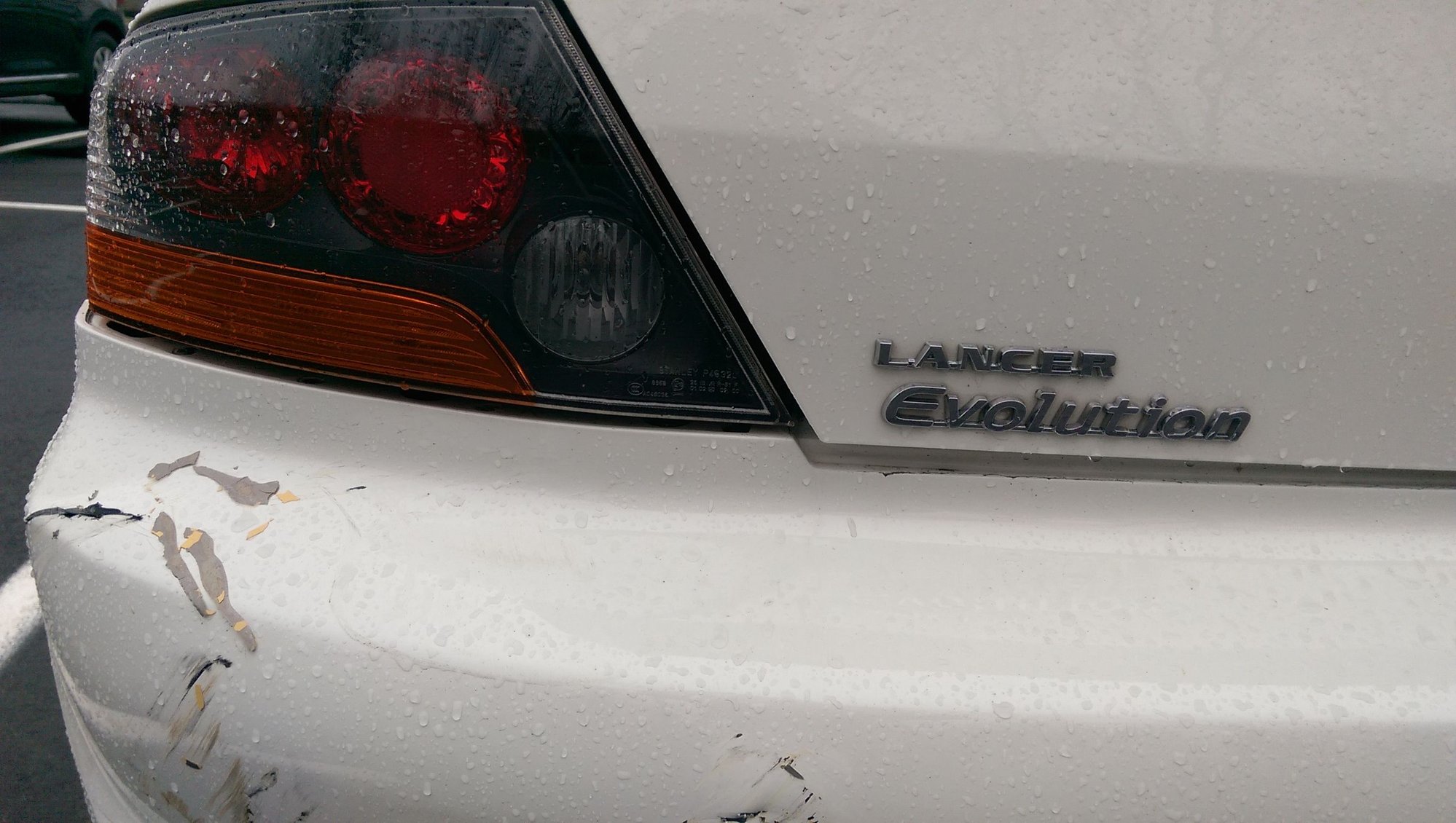

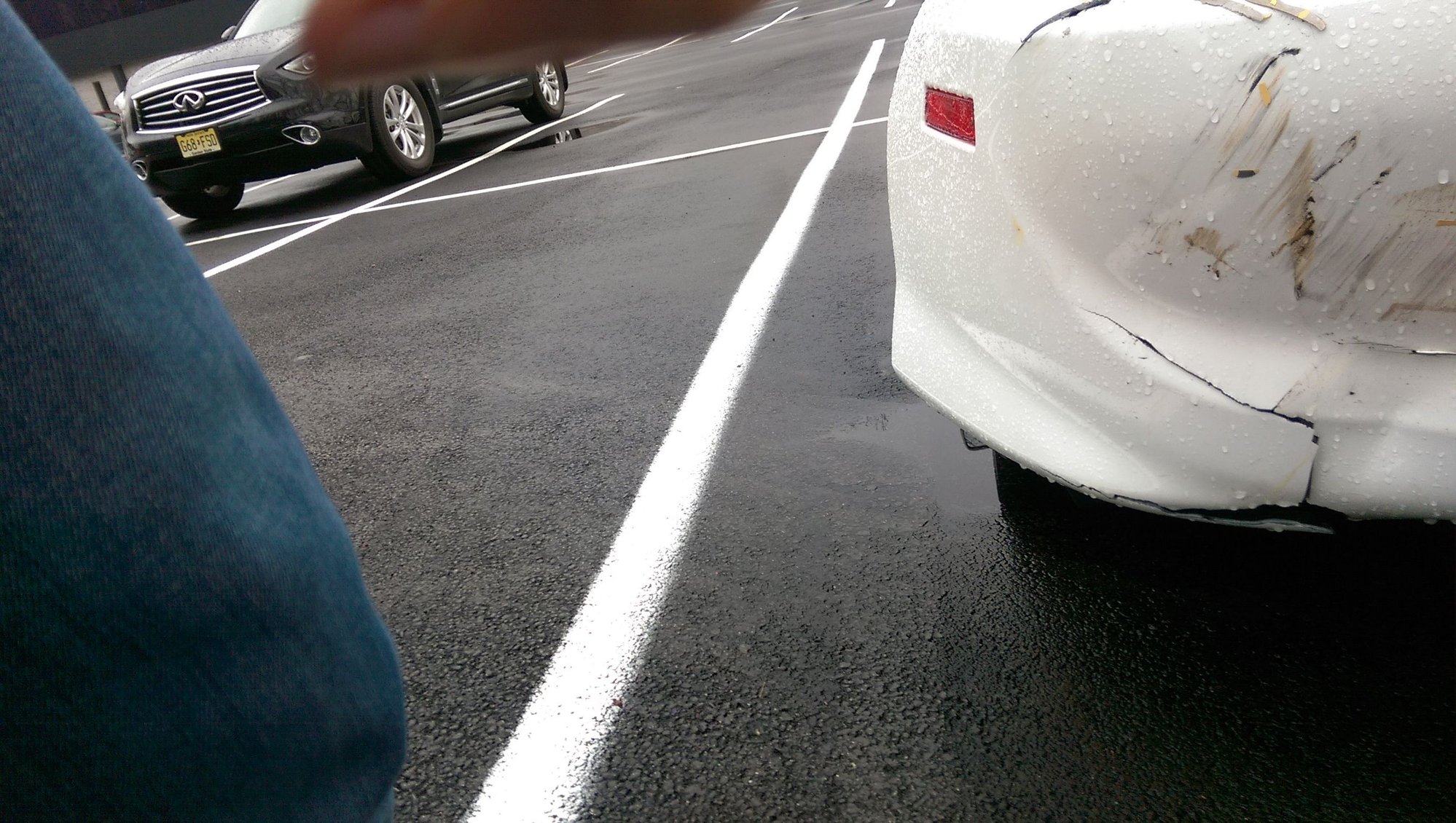

I got rear ended on my way to work today. I merged behind a gypsy cab doing 40 mph on 55 mph highway and a lady traveling down the highway smashed into me... I don't know how fast she hit me.

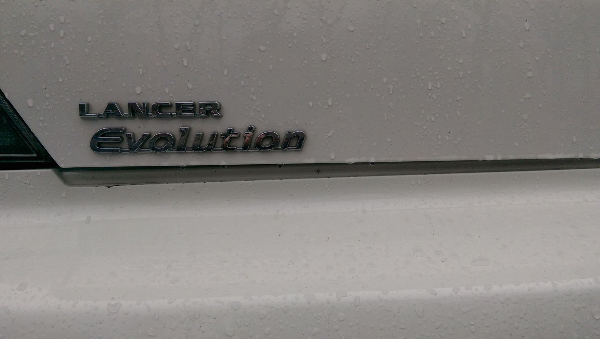

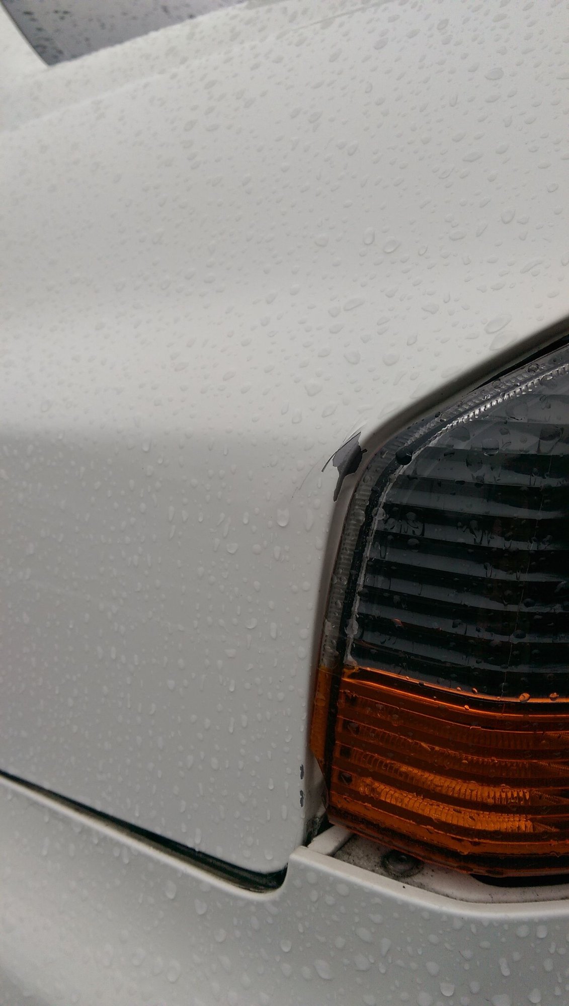

Here is the damage. I didn't think it was that bad until I saw the the trunk looks to be crooked... What do you guys think?

doesnt look aligned anymore. only insurance claims people will tell u how it is. internet folks will just blab about...

I'm sorry this happen to you mate. Luckily the damage looks repairable and nobody is dead. The repair shop will most likely drill out the spot welds and replace the entire driver side quarter panel. They will probably keep the trunk lid as it didn't really sustain any damage.
That side of the car has your evap/fuel lines. I'm sure that if anything happen to them you'd know by know.
Good luck with everything, hope she pays for what she's done.

May be a bit more damage than you think there. Would have to look inside the trunk and such. Anything can be fixed in the hands of someone competent

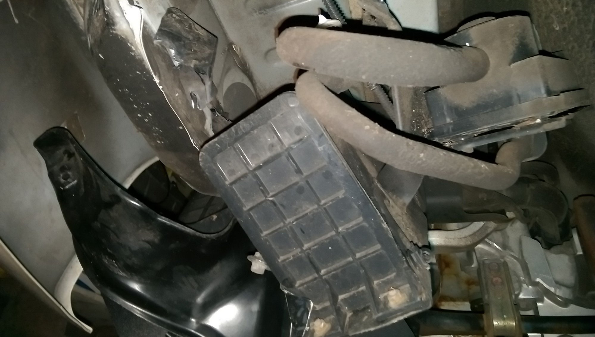

Well it looks like something may have happened to the evap/fuel lines... My check engine light came on as I driving home from work today..
First question: How stupid would it be to drive the car with these things dislodged and without reading the code first? I was thinking of driving it to work tomorrow as one of my co-workers has an OBD reader.
Second question: Can a body shop be trusted to fix / replace the evap / fuel lines?

I just went to the body shop to pick up some more stuff out of my car, and the owner showed me the damage inside my trunk. The floor of the trunk is pushed in... He says he will probably have to replace it...
I want to cry The car only has 46k miles on it and it will probably never drive the same

That all can be fixed don't freak out. Modern frame machines are digital and use specs supplied by the factory to realign. Glad your ok. Maybe this is a sign to go by a final edition haha
