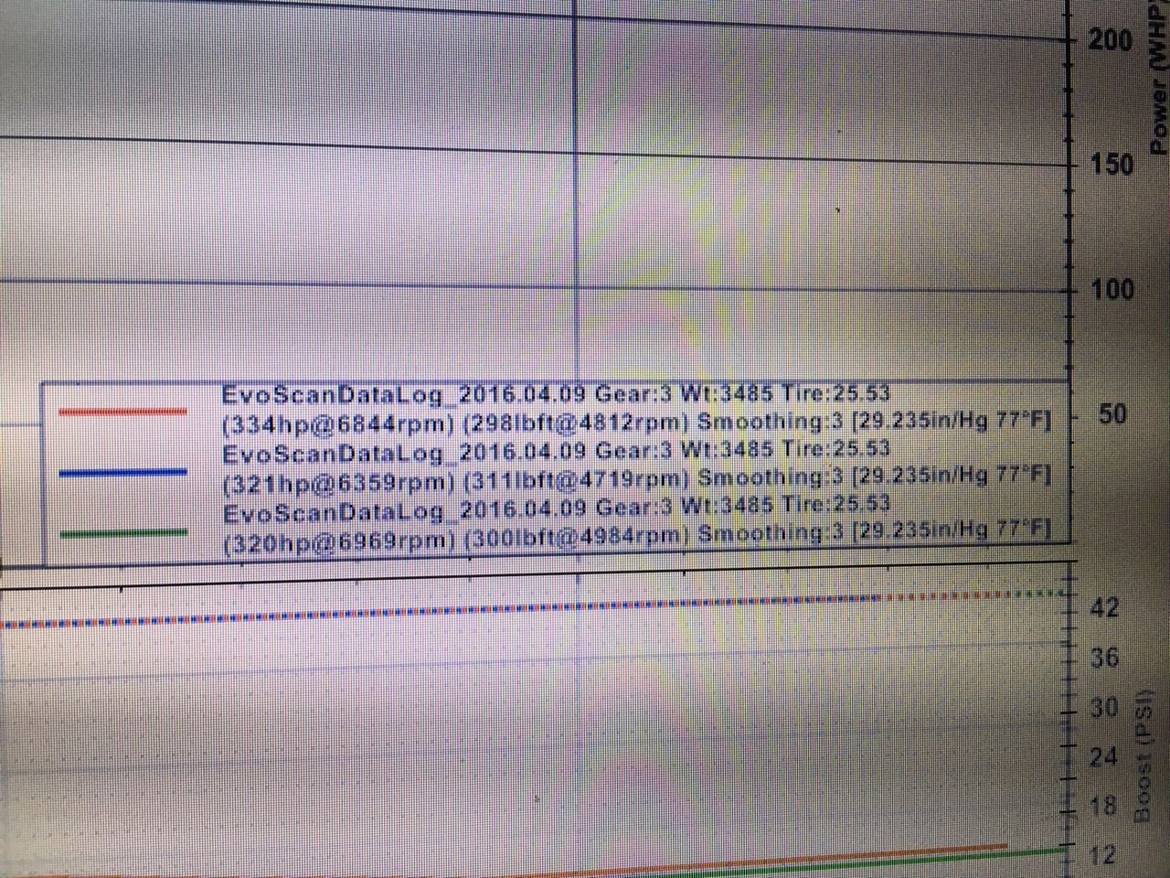

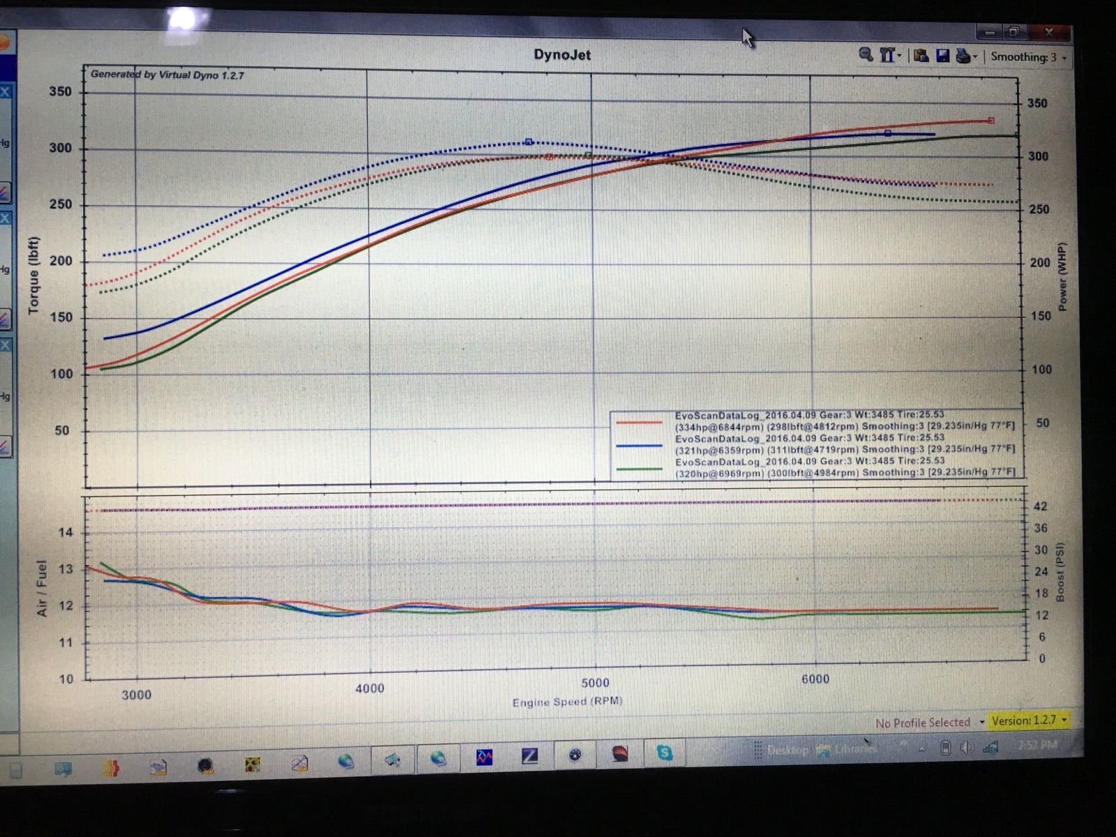

Hi, just got tuned a few says ago and was wondering if the results looked right to you guys? I have heard some things about the tuner, and just wanted a piece of mind. On stock 9 turbo and 91 octane.
Mods are: Rebuilt stock motor with arp head studs, walbro 255, O2 hood dump, MBC running 24 psi, intake, exhaust, and test pipe.

What turbo? What fuel? Torque is really low

Seems a little lean for 91 octane..
looks like its under 12 while in boost and 11.5 at redline?

Yea, that's a little lean for ACN 91. It tends to be happier closer to 11 flat.

too lean for 91, should hit max torque much sooner also. try another tuner.
