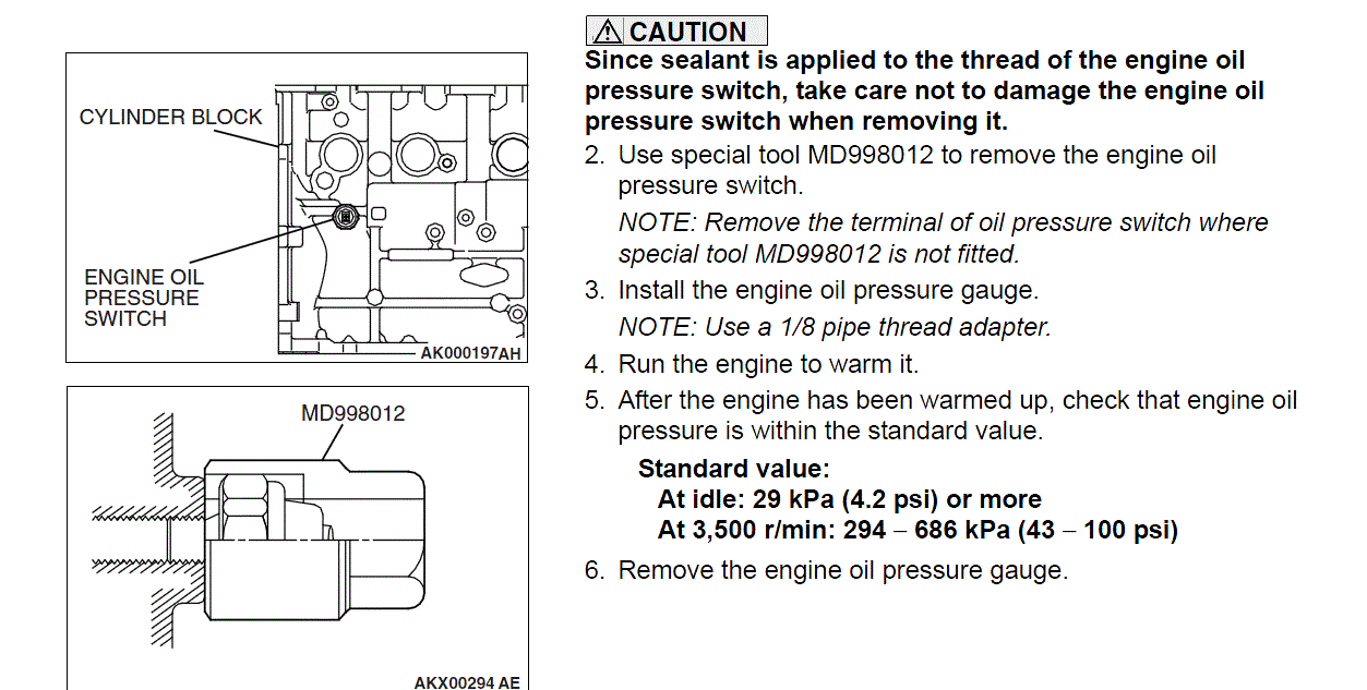

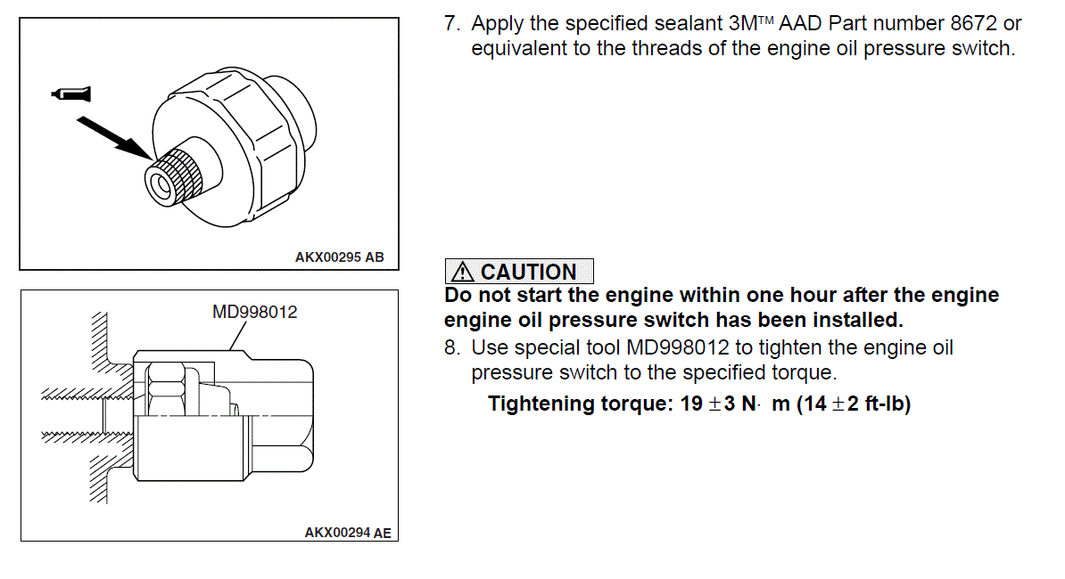

Heres the manual if needed

The image above I believe is for the Evo 8. The Evo 9 sensor is by the oil filter.
