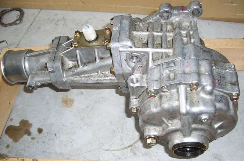

Does anyone know what purpose the little white plastic cap plays on the top of the TC in the middle of the square plate?
This is a picture of someone else's but mine has a smaller steel cap on it that appears to be like a little valve like it lets air in and out, I think the plastic caps has broken away and fallen off, is it important?

It's the breather/vent.
