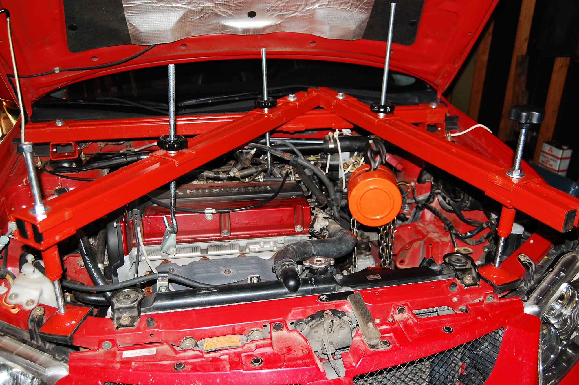

I dunno about the six speed, but on the five speed, on the selector shaft bracket there's a maybe 3/8 inch hole that is at the transmission's exact center of gravity. In other words, connect there and when lifted the transmission hangs level. I'm guessing the hole is there to facilitate moving transmissions around at the factory since they are so heavy.
If you can rig something to suspend the transmission, stabbing it is easy. I had a fancy engine hanger and an old chain fall hoist I got from Menards. With that I could easily move or tilt the transmission as required. Here's a picture.
