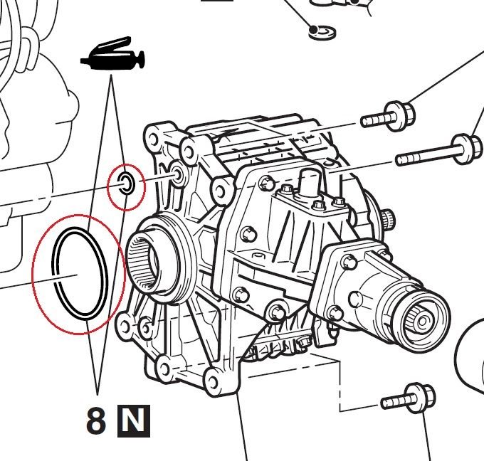

Old Jun 11, 2018 | 10:56 PM
qsiguy's Avatar
Joined: Oct 2015
Posts: 62
From: Arizona
I've recently found my TC leaking from what appears to be the breather. No whine or any unusual noises, I think I caught it quickly. The closest thing I have found searching the forum is that seals between the trans and TC may leak and allow pressurized tranny fluid into the TC causing it to overflow and leak out the breather. I plan to first check the tranny fluid level to see if it's low. It was rebuilt within the last year and the car doesn't leak a drop of fluid (until now) so it shouldn't be low. If it is it's safe to assume it's in the TC. Next I plan to check the level in the TC. If it's high that is further evidence that the tranny is leaking into it.
I read there are 2-3 o-rings that can fail and allow this leak to occur. First question, does anyone else know of this situation? Second, are the two o-rings listed above the o-rings in question (I've also attached an image from the manual)? Third question, how would these two o-rings allow tranny fluid into the transfer case? There doesn't appear to be any pathway from these o-rings into the T-case.
If it's not these o-rings I need to replace (assuming the above is my problem) which o-rings or seals do I need to replace?
Old Jun 12, 2018 | 09:21 AM
kaj's Avatar
kaj
iTrader: (60)
Posts: 13,634
Likes: 824
From: Fresno, CA
I've never seen them fail, but they are only rubber or vitron, so it's possible. I have seen installs where the small o-ring falls out during install. The larger ones don't usually cause a problem but, again, anything is possible. How long ago was everything installed and when did you start noticing the leak? I can't see how a missing o-ring would cause anything to pressurize; it should just leak. Maybe I'm missing something too? LOL I'm just trying to walk myself through it, logically. I dunno, man.
I haven't heard of leaking from the vent, so sub'd for a fix.
Old Jun 12, 2018 | 08:54 PM
qsiguy's Avatar
Joined: Oct 2015
Posts: 62
From: Arizona
Owned the car for about 3 years. Had the trans and clutch rebuilt about a year ago. Been working fine, not a drop since. Gave it a bit of a workout the morning of 6/2/18 because I had to use up some fuel (can't have more than 1/4 tank for the show), had it in the Scottsdale HIN show that day and on the way home after the show started smelling the gear oil at the stop lights. Looked under it when I got home and noticed the oil on the exhaust under the T-case. Not dripping a lot, even after sitting for a week and a half just a very small "puddle" under it. I can see it around the breather and of course it has dripped down around on a few parts.
