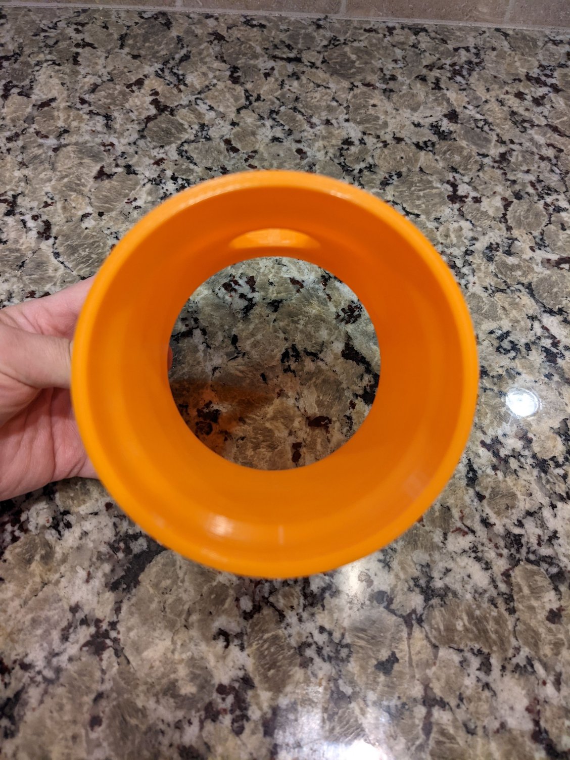

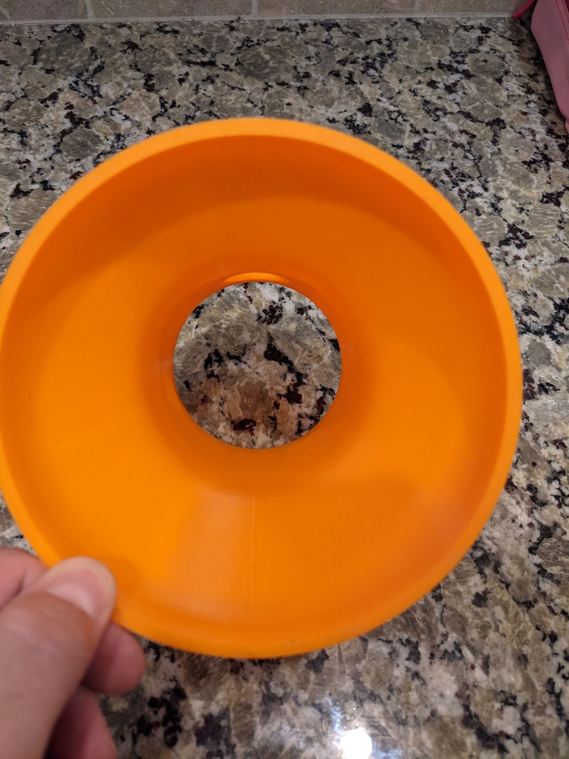

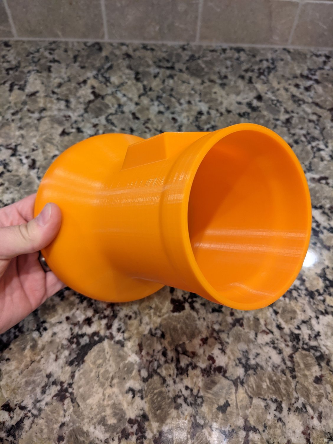

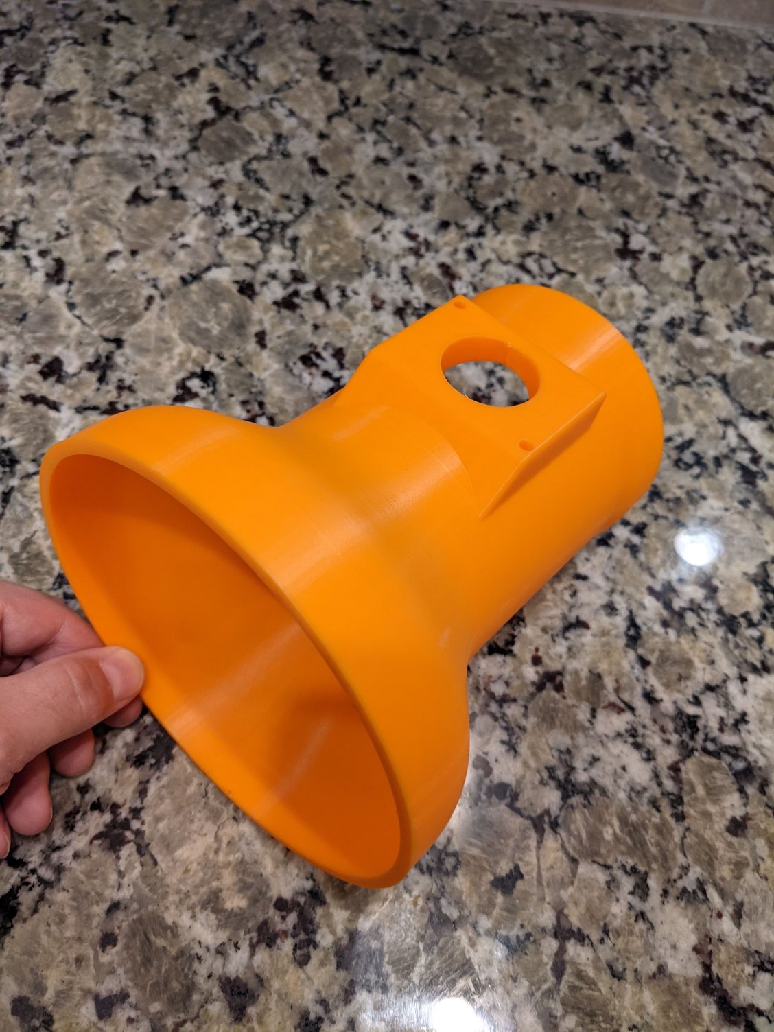

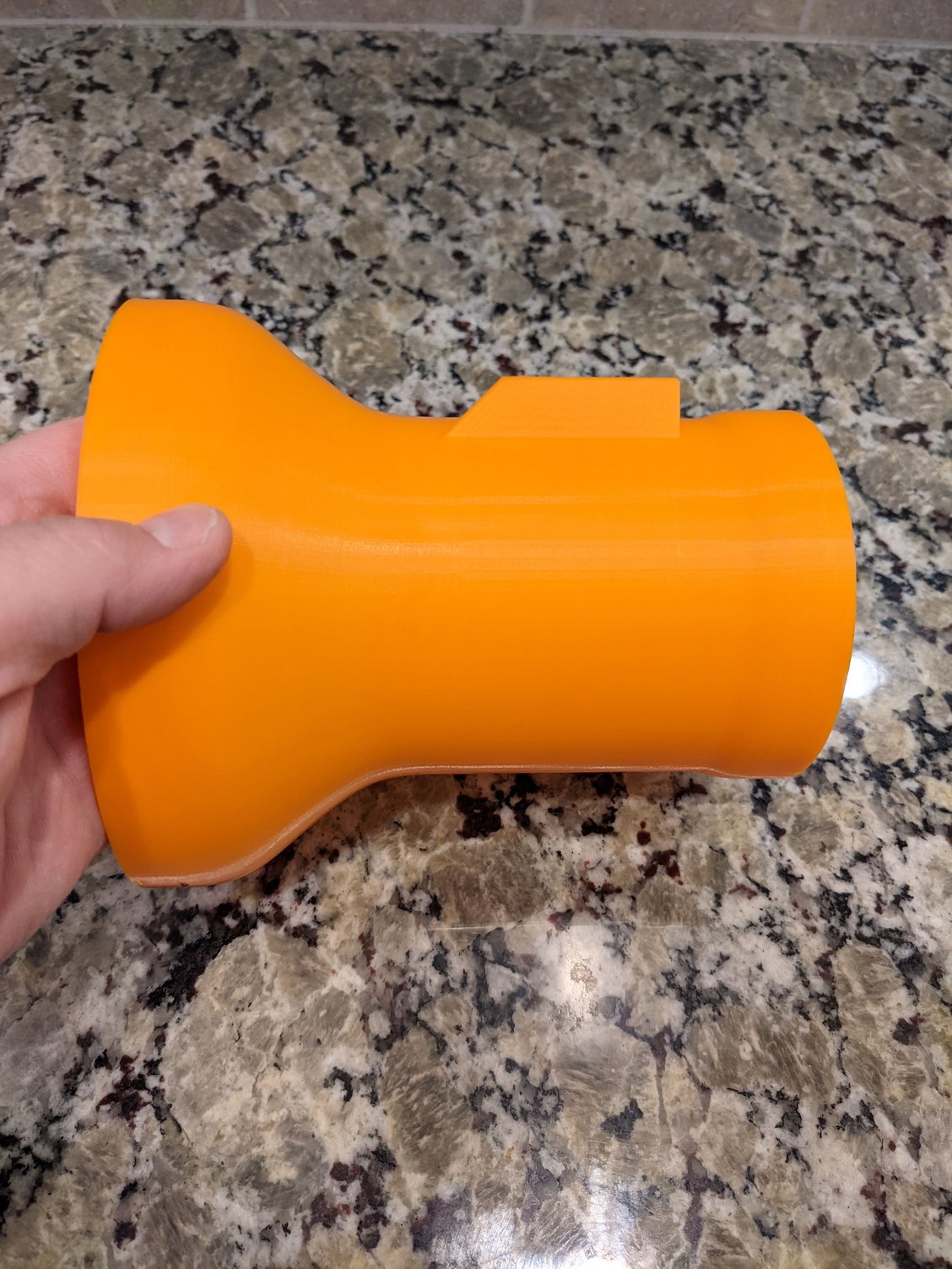

Prototype in orange PLA for fitment testing:

Thats a great print! Printed it out on a Prusa or a different 3D printer? Probably took like a day depending on infill percentage.

I do have respect for Prusa printers....However the printer is actually a massively customized QIDI printer that has an LDO Orbiter 1.5 extruder with Phaetus Dragon hotend. The setup is good for a 120C bed temp and 500C print temp.
It did take 17 hours with CUBIC infill at 30% with 3 walls.
and thank you for the print complement!

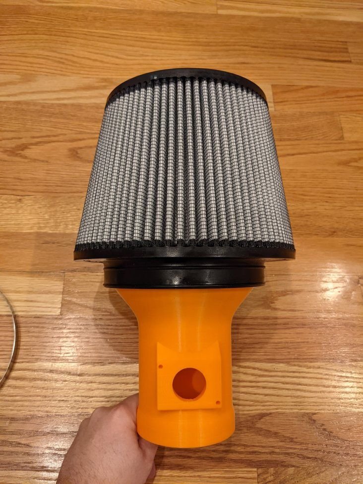

It fits perfectly!
