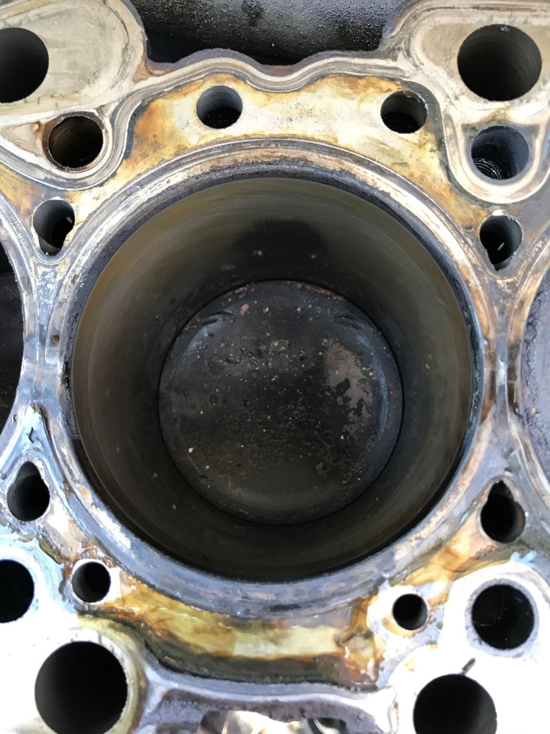

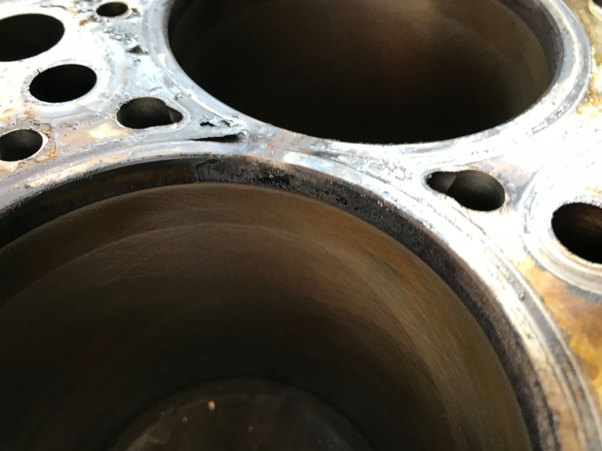

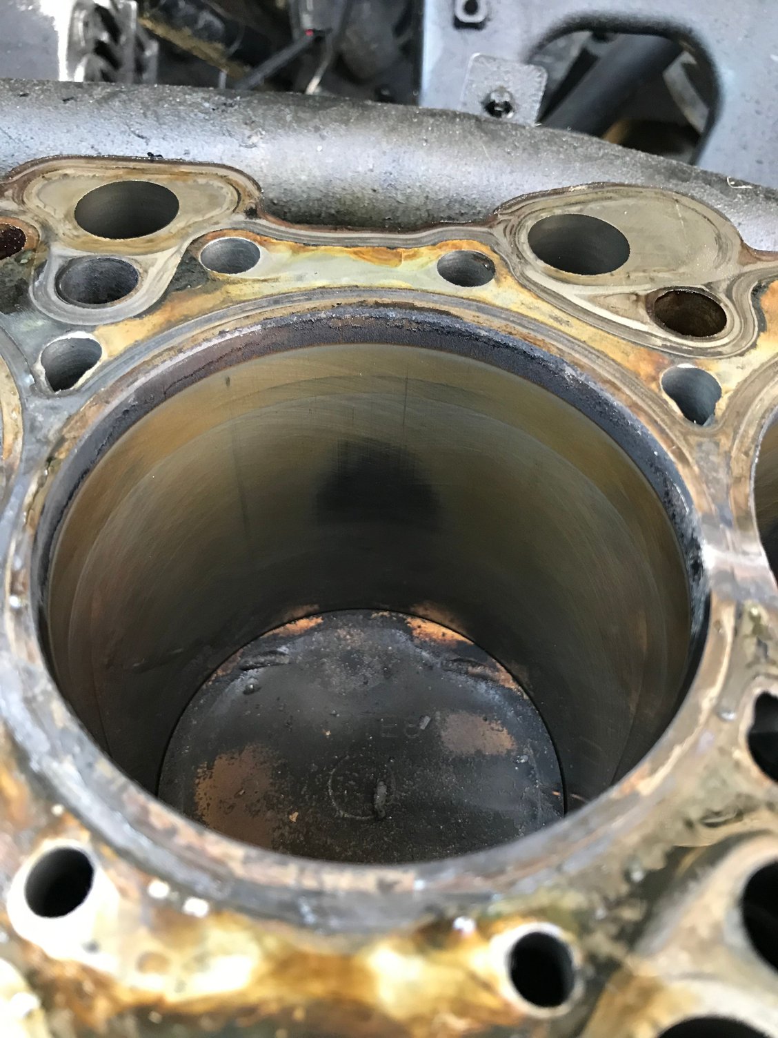

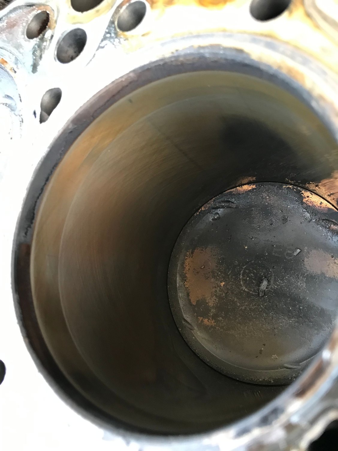

Evo 8 motor build.
Should I get the block resurfaced/bored/Honed?
Should I get the head worked on? Ported/resurfaced?
What happened?
The head gasket blew.
I have almost 250k miles on the motor. And I figured why not do the work no instead of opening it apart again later. Everything is stock right now except a walbro255 fuel pump, I believe a set of 650 injectors (previous owners’ word), and an evo 9 turbo. And a Coil on plug set up. act street clutch and pressure plate. Mishimoto radiator hoses and fan.
At the minimum I’m going to replace the bearings, rings, gaskets and hoses that broke due to old age. Depending on the shape of the pistons and depending on what you all recommend. Replace them with stock pistons.
But my overall goals for the car are to make it a fun daily driver about 400-500hp on 93pump gas. I know there’s multiple way of going about this and I know it’s more reliable to build bigger than you need and just tune it back. But should I go with say a MAP rebuild package (https://www.maperformance.com/produc...dsm-7-bolt-evo) or (https://www.maperformance.com/produc...dsm-7-bolt-evo) just options not completely set on a product or dealer. Up for discussion.

I think you should give English racing a call for getting the block/Head rebuilt. If you're debating between the green and black, the red will spool a little faster than the black and get you to the power goals.

Do all the build block and head surfacing plus
20 thou
torque block
guides
Rods
Pistons
bearings
studs
fp red
Walbro 460
oem rebuild kit including all belts and pumps

The head needs to be resurfaced at a minimum.
