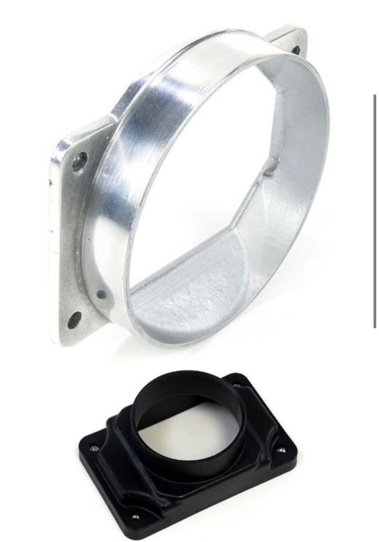

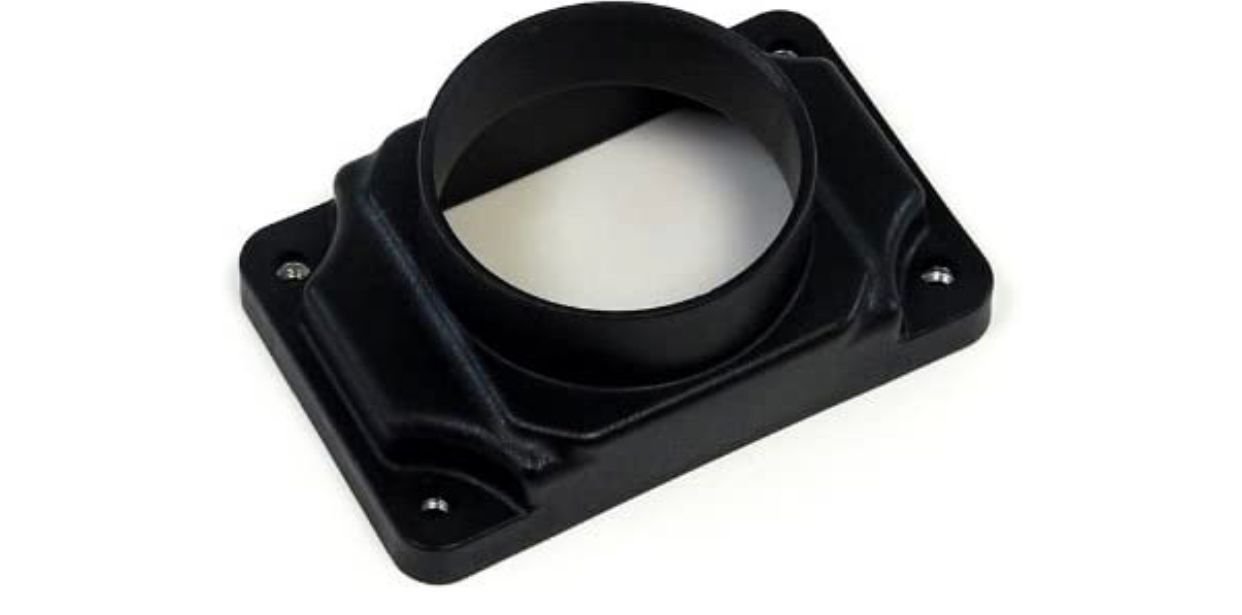

Hey guys, I’m just stuck between doing a 4.5 intake adapter plate or a 3 inch adapter plate for the MAF connection on the intake on my evo 8. Just wanted your opinions on if there might be a difference in power when tuning between the two or that really won’t make a difference and is only for connection purposes obviously. Thanks !

Just do speed density and get it over with. The car runs nicer anyways on speed density.

The bottleneck here is going to be the MAF. It merges down to 3" so I dont see much additional power if any to be had going wiht a 4.5" pipe then reducing to 3" for the MAF. If youre concerned about it just convert to SD and call it a day.

Had to edit my last post and yeah speed density it may be then. Tuner told me unless I plan on passing 550 or 600 whp stay stock maf. Wha do you guys think?
