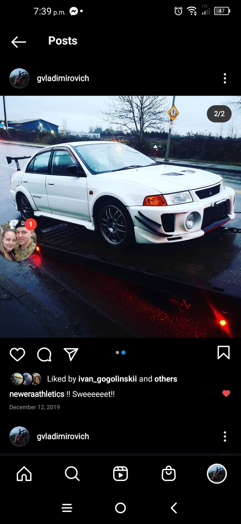

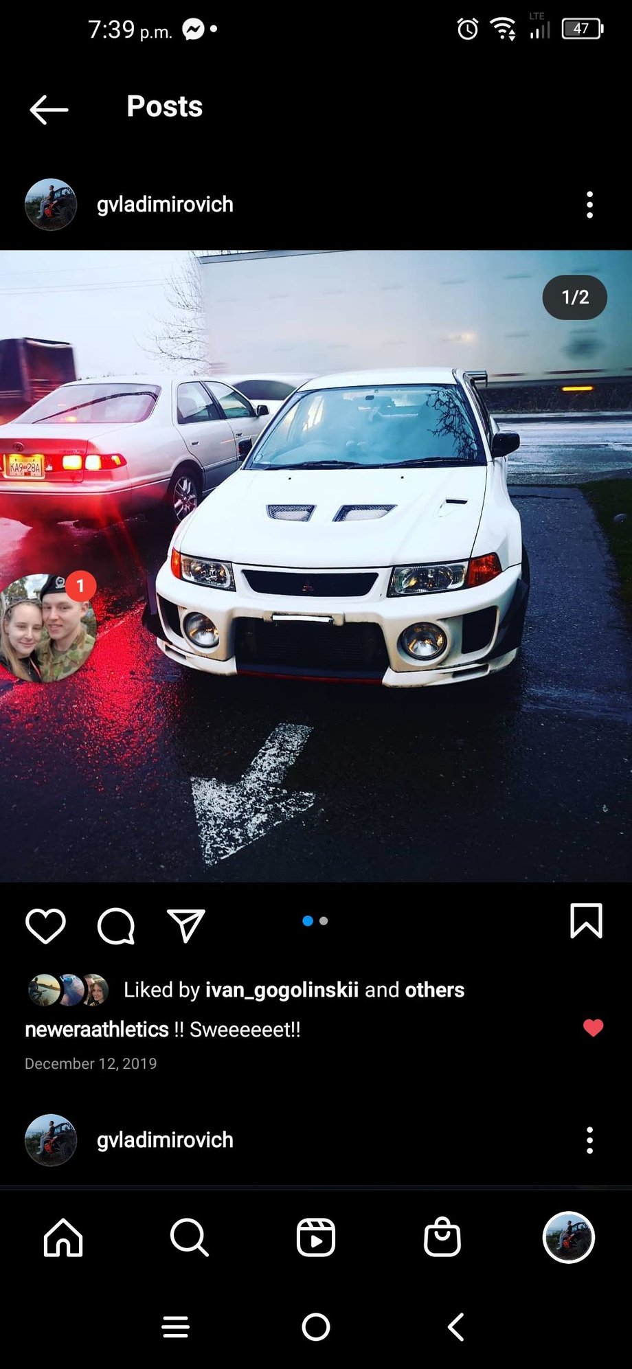

Hello guys, cant find my old username so created a new one.
been on here for a while and learned a lot.Thank you for that.
after 3 years of the car sitting with a blown motor,decided to do a build.
Let me know what you guys think.
KM627M8650AP Wiseco pistonsKing bearingsEverything is arp 625
tomei headgasketManley 156 hplus rods/arp 625
276 camsBeehive springs
for now just doing the engine,FB black would probably be the turbo option.
Ultimate goal is a DD that's fun on twisty roads.
