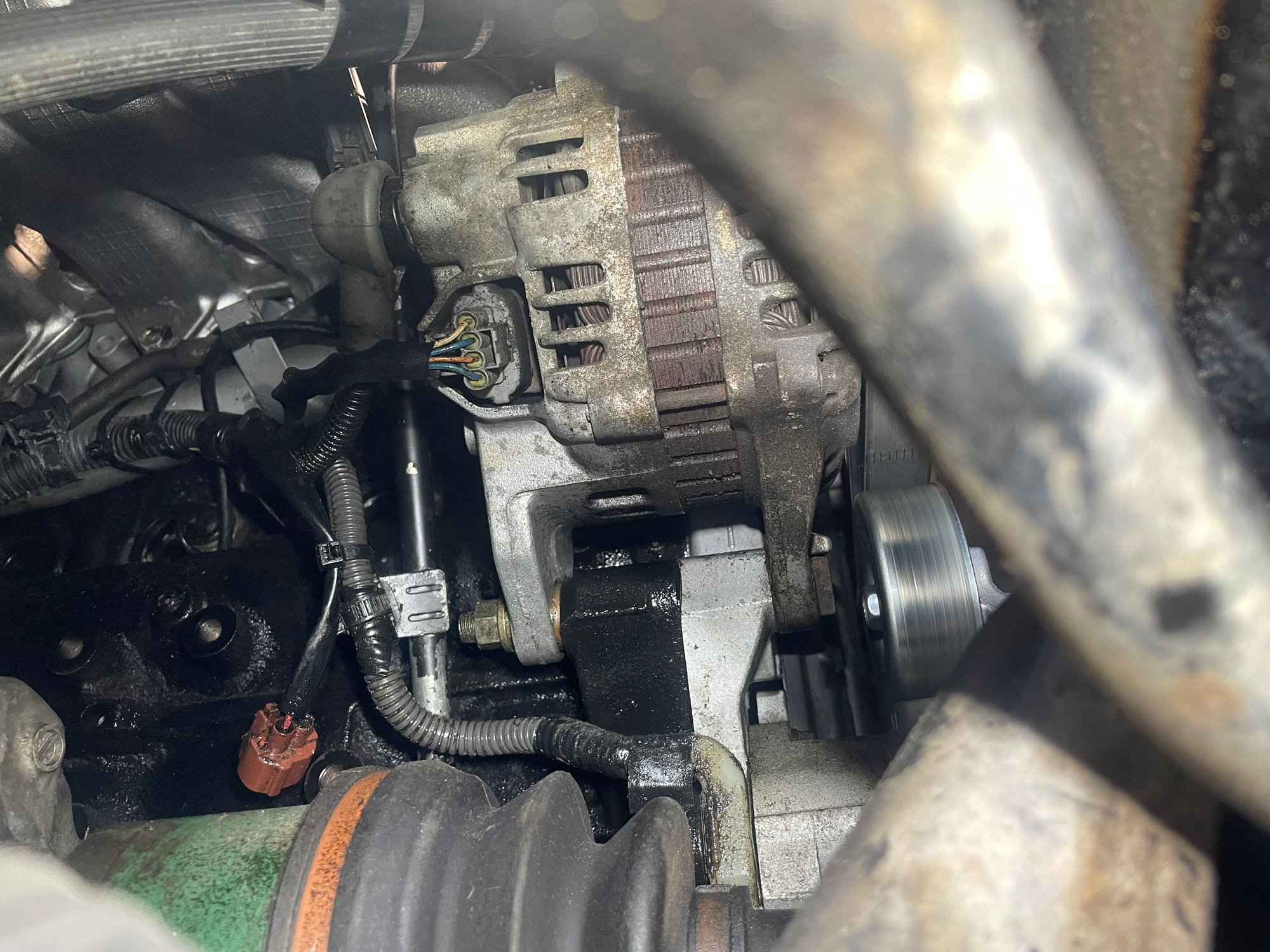

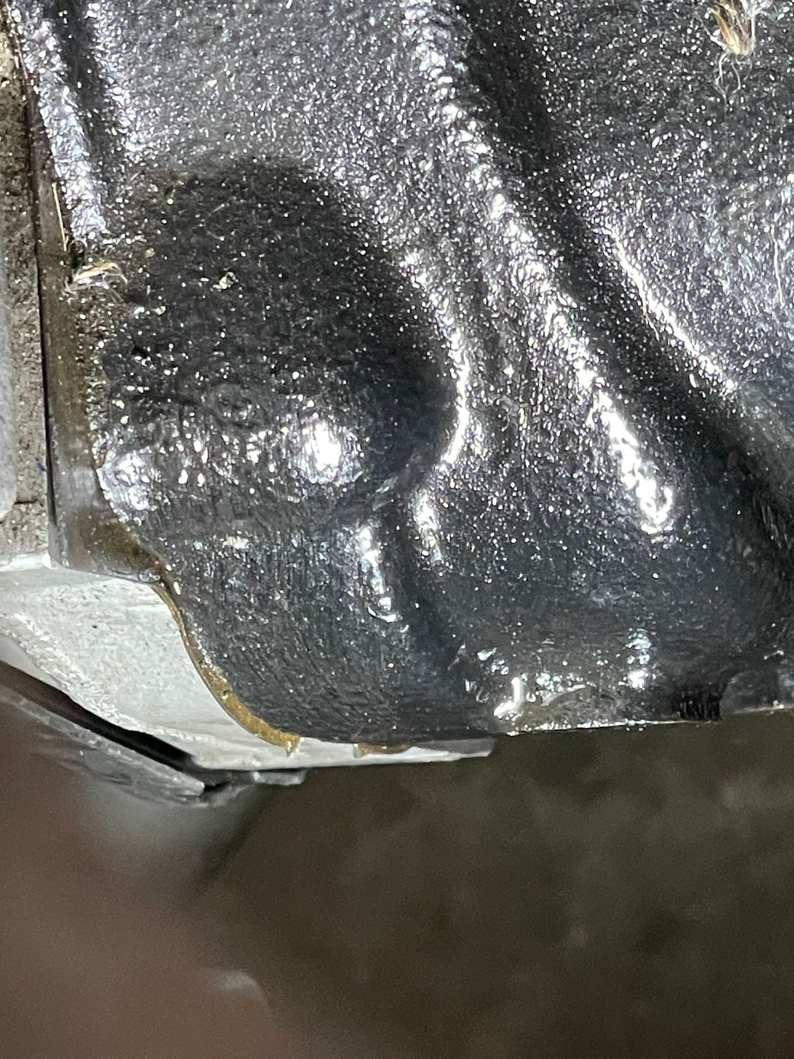

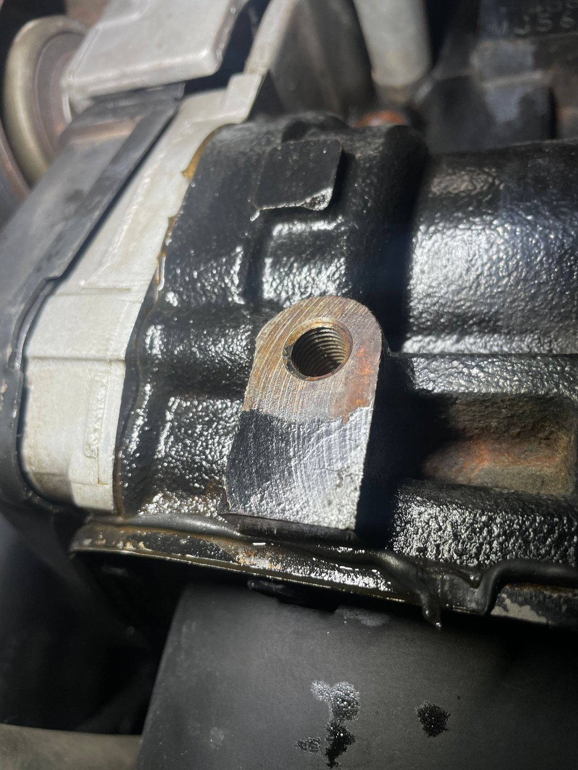

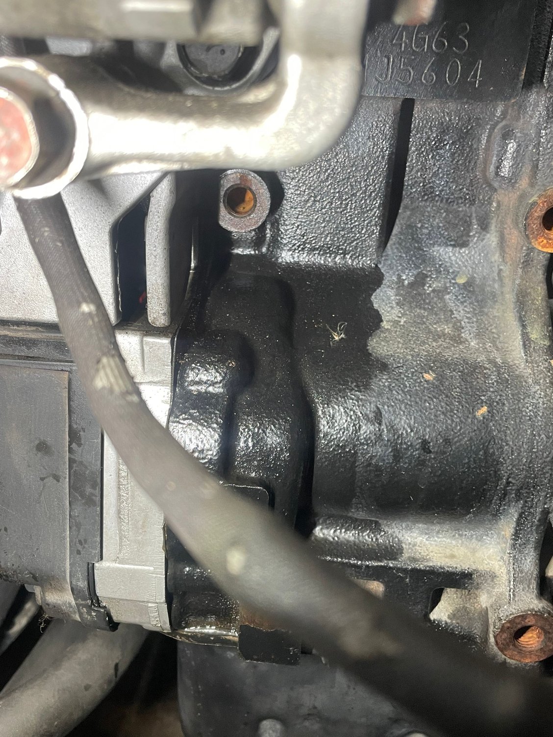

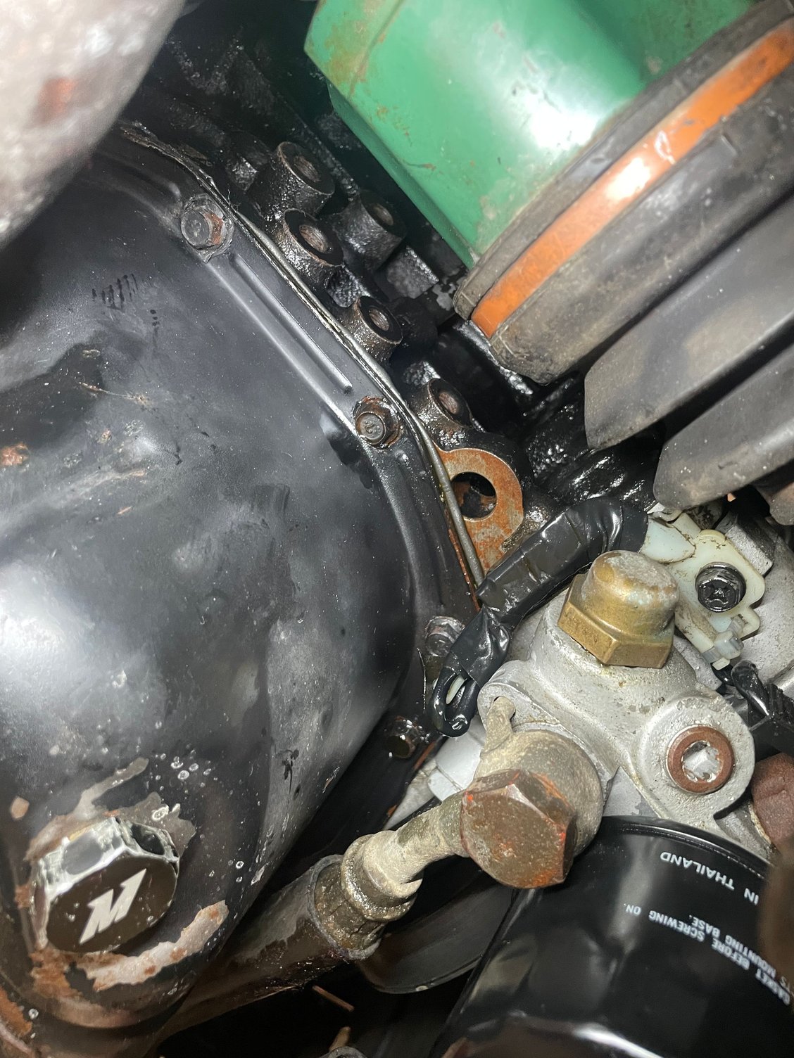

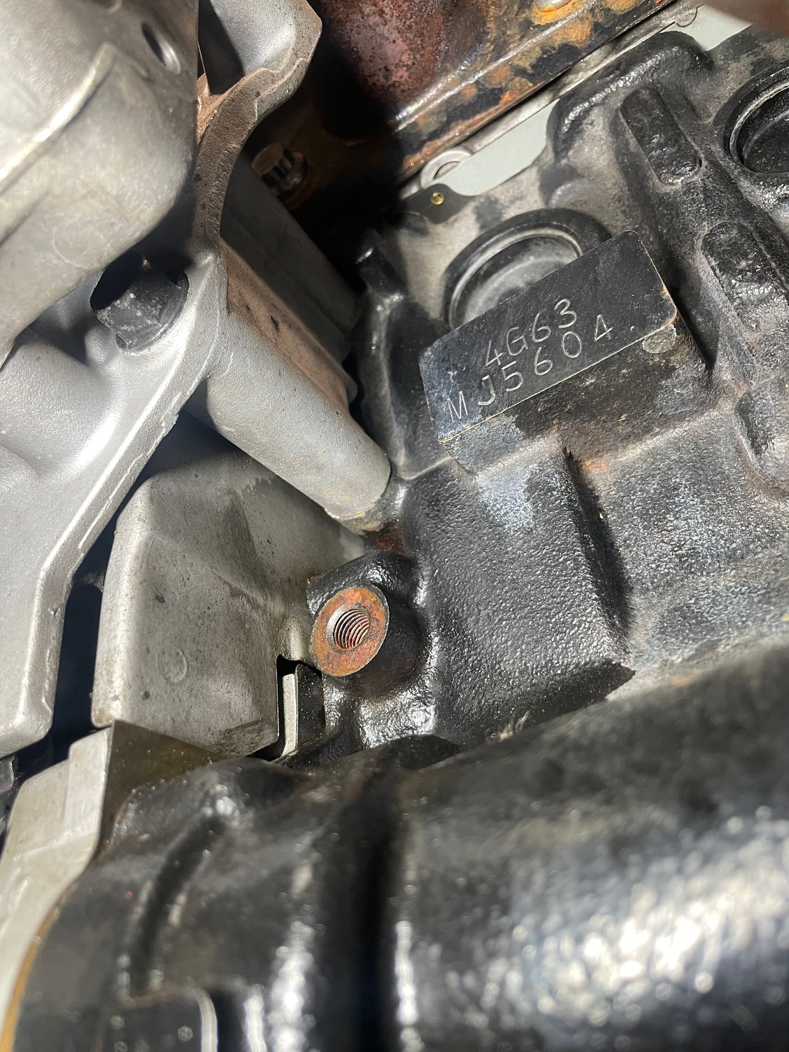

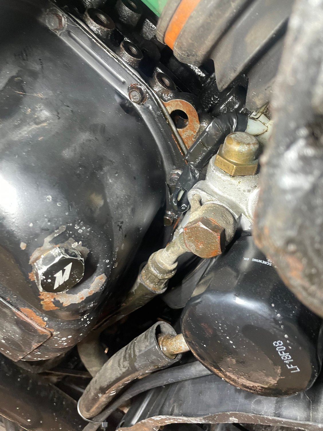

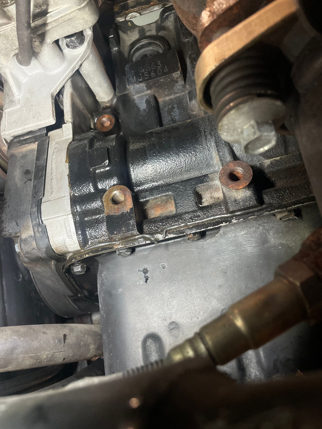

I have an oil leak problem and I wanted to know if anyone has any ideas, I’ve changed the head gasket and then did the timing belt and I noticed oil was coming out near the crank shaft so opened everything up the second time and I bought new tensioner and pulleys I bought brand new seals for the crank, oil pump and rtv the engine mount bolt and ect, from the pictures I provided the leak is below the engine mount and is on both sides of the block note only half of the oil pan is wet (the side closer to the crank)
I was thinking it could be the front case oil pump gasket (md322522) if anyone has any ideas please let me know thanks

Degrease and get yourself some UV oil dye. Might make things easier. I've had VC and cam seal leaks that once created a leak like the photos you supplied above.

I think someone mentioned the exhaust manifold studs go into oil passages(?). mine leaked a bit at #4 cyl before my engines build(s)

Yes all the upper exhaust manifold studs holes have oil passages in the backside of them
