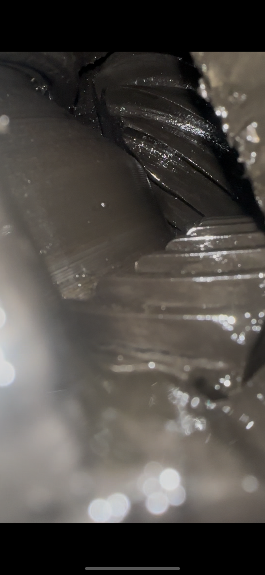

I didn’t find that much damage but this is what I noticed from the that cover plate
The pinion gear looks pretty sharp but don’t know if that’s how they are

I can see what look like metal shavings and the oil is a muddy color and yea the ring and pinion gears look pretty chewed up...not looking good to me.
