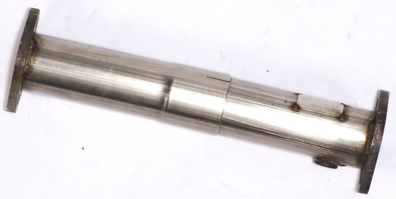

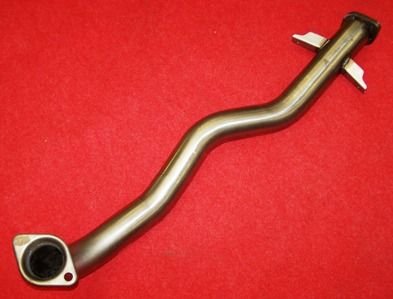

The company recommended me to go with:
- Mongoose 3" Downpipe
- Mongoose De-Cat
Downpipe
Downpipe
De-Cat (test pipe)
De-Cat (test pipe)
They mean it's a affordable setup and will do the job just as good since the Stage 1 upgrade (in terms of Hk/Nm) doesn't require the most extreme parts.
