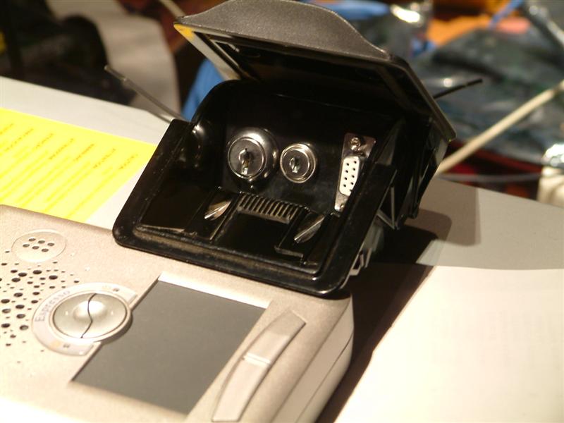

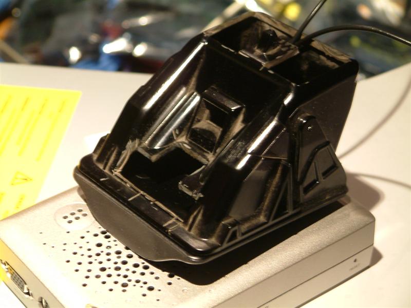

Ok, time to start catching up on some misc. stuff I've been working on.
First off, the "Ashtray Project". It's coming along nicer than I thought it would. Here's some pics of the initial mock-up. Left keyswitch (momentary switch) is to calibrate the LC-1 wideband sensor, right keyswitch is to switch between the XEDE maps, and I decided to extend the XEDE serial interface as well.

loooks good

thats pretty cool lookin. I'm guessing you're not a smoker haha..

looking good
