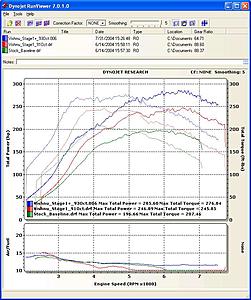

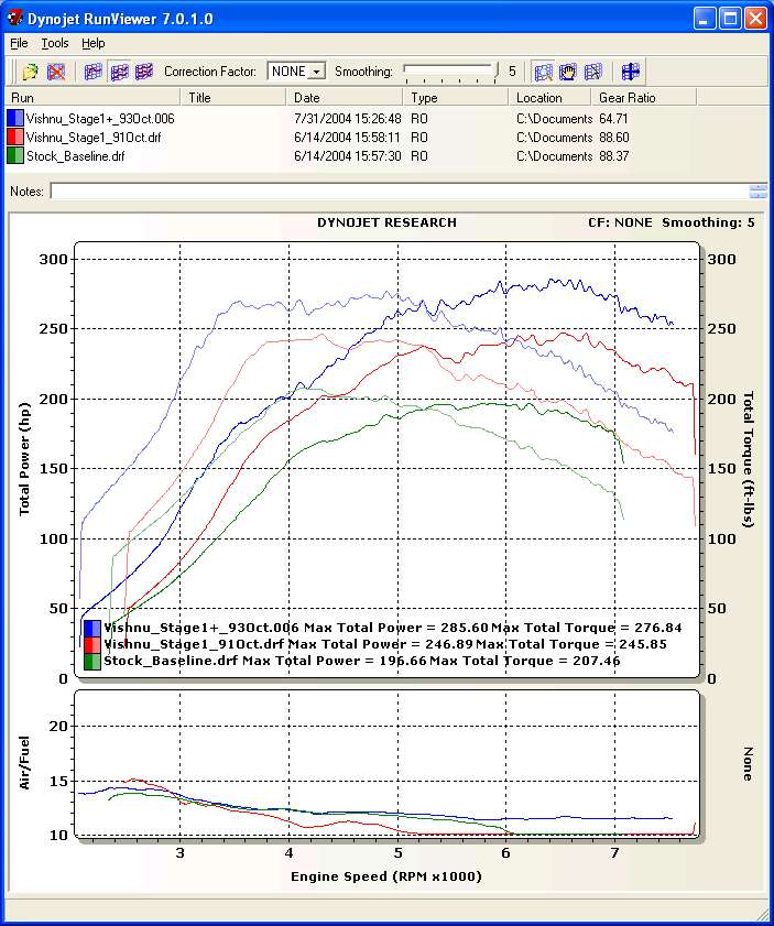

Last updated for a while.... here's the dyno comparisons. These are uncorrected numbers and to be fair, it should be said that the first two runs (baseline and stage1) were done at altitude with 91 craptane gas...

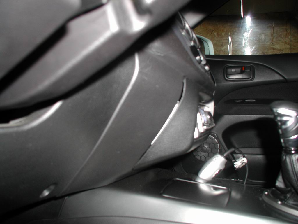

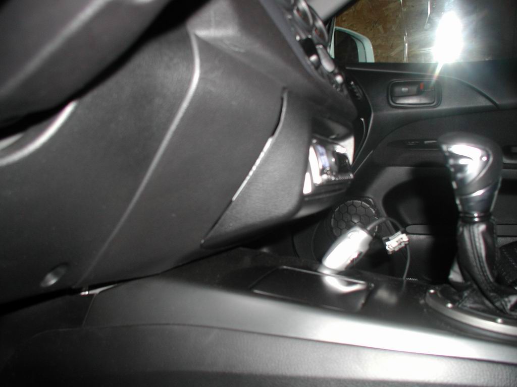

ok, hate to bring up an old thread...BUT, where did you get your gauges? or where have you guys found to be a good site with descent prices on guages. i wanted the defi BF series, but i don't want my boost guage to read bar and i don't really want 60mm. any of you guys fit 60mm gauges into the center panel shown in this thread?
Posts: 6,224
From: 41° 59' N, 87° 54' W
People have fit 60mm gauges into the panel. Search for "craighardy" ... there should be a huge thread on that panel.
I got my Omori gauges from Vishnu. If you do end up getting them from Vishnu, and they don't come with the right fittings, lemme know and I can tell you where to get the correct fittings.

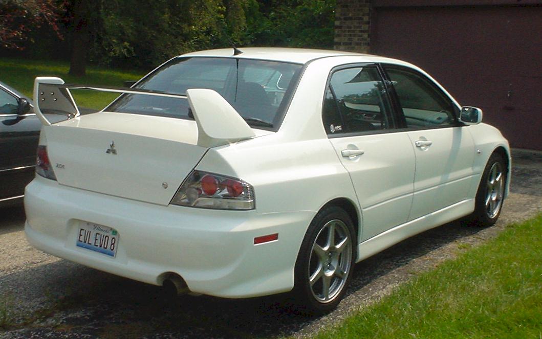

Wheels are (off the Discount Tire sheet):
p/n 53651 - 18x8 5-114.3 30BR MB Motorsports Weapon 789 $164 ea.
and I had them put Continental Extreme Contact 235/40R-18 tires on the rims. So far I am very happy with the rim/tire combo. Although the Extreme Contact tires aren't as sticky as the stock Advans, they are still fairly impressive and track nicely in rain and snow. The car feels noticeably softer with these tires vs. the Advans and is less nervous, but doesn't turn in as fast. So basically a good winter tire setup that goes well with my detuned winter map, but I can't wait to get back to stickier tires in a month or so.
