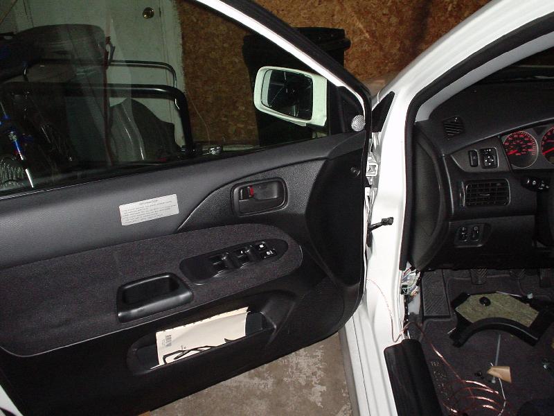

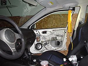

Arrow Install pics...
Ok, here's the front speaker installation...
Attached Thumbnails My Evo work-in-progress pics-evo_passenger_door_speaker_install_in_progress_sm.jpg   My Evo work-in-progress pics-evo_passenger_door_speaker_install_done_sm.jpg   My Evo work-in-progress pics-evo_driver_door_speaker_install_done_sm.jpg

Just a couple ?'s
How good is the stock wiring to the door speakers?
How much of a pain are the door panels to get off/on?
Did you leave the pillar speakers hooked up?
Nice setup tho I had those same speakers & alpine amp in my celica
Old Jun 8, 2004 | 07:09 PM
db8 na's Avatar
Posts: 110
From: NJ
lookin good!
Old Jun 8, 2004 | 07:24 PM
Ludikraut's Avatar
Posts: 6,224
From: 41° 59' N, 87° 54' W
Post ...answers
Originally Posted by justchil
Just a couple ?'s
IMHO the stock wiring to the door speakers sucks a$$, the reasons being:
- does not use a crossover for the front component speakers
- front speaker wiring is simply split into two as part of a PITA harness that's located near the wheel wells in the passenger compartment (one on each side)
I chose to route new wiring completely ... if you look closely at the door pics, you'll see where the new speaker wire (wrapped in white electrical tape) goes from the door to the passenger compartment. Also because the Infinity's use a crossover, I chose to mount the Infinity tweeter on the door instead of trying to use the stock location.
Not bad at all. I did get a copy of the service manual ($cheap$ off eBay), which showed me where all of the mounting points were at. As long as you use something flat and wide (read: not a screwdriver, rather something kinda like a bottle opener), the panel comes off without too much of a problem. It re-assembled fairly well also, meaning that I didn't pick up any additional rattles
Nope, they are still connected to the stock wiring, but since I bypassed the front speaker wiring altogether, they are off. For the rear speakers I did use the stock wiring, I even bastardized the stock speakers and connected the Infinitys using the stock speaker harness.
All-in-all it sounds 1000% better than stock ... also got an Infinity Basslink sub waiting to be hooked up, but I'm going to wait until I relocate my battery to the trunk b4 I hook it up.
