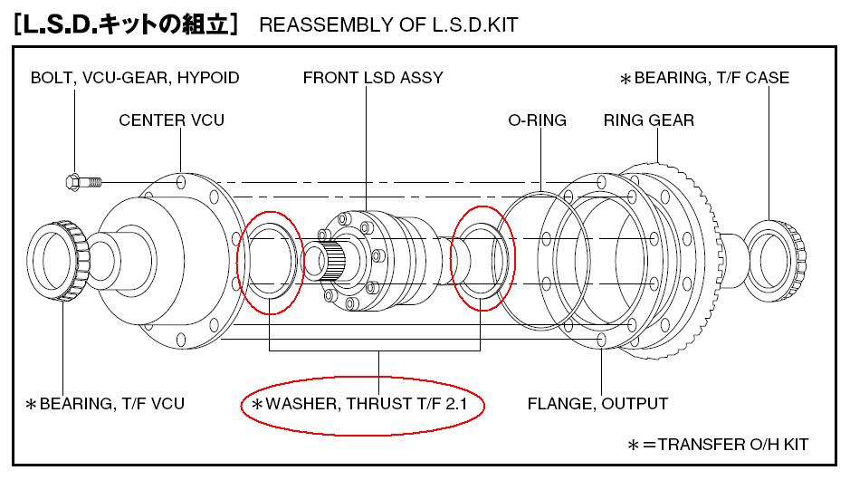

3) Remove stock front diff, swap over thrust washers to quaife, and reinstall quaife into the carrier housing
4) You can now change the carrier o-rings if you have them
5) Reassemble the two halves of the front diff carrier assembly
- Be sure to lube the o-ring and mating surfaces to avoid any possible o-ring rolling or pinching.
- The flange surfaces of the two halves should mate together w/ little effort. If there is a gap between the two flange surfaces, separate them and check to make sure the plastic thrust washers (circled in red above) are centered

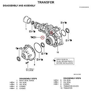

7) Change transfer case cover o-rings (the small o-ring and its’ install location are circled in red above)
