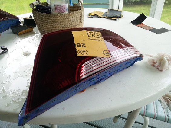

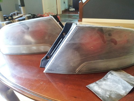

Used the Krylon Stained Glass paint, the 1/4" tape, and bought some urethane clear coat.
3 coats color, 4 coats clear, wet sand with 600, 800, 1000, 1500, 2000, and 2500 grit, buffed. The finish is nice. I also swapped the turn-signal and reverse light bulbs in their locations, so that my reverse lights stay white.

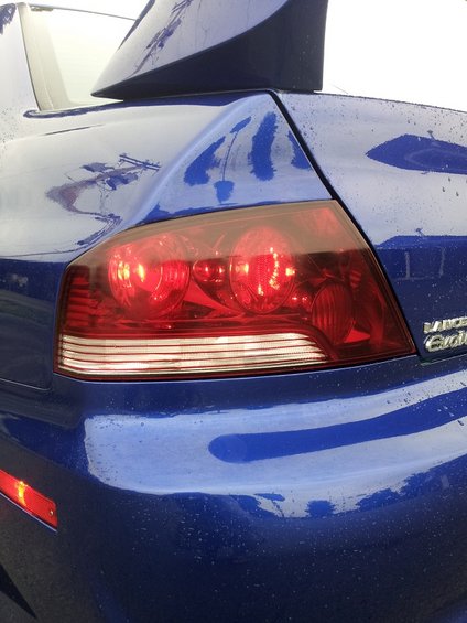

I couldn't find the red glass paint, except on ebay for 50$+ bucks a can. I came across another diy using Duplicolor Metalcast MC200 Red Anodized.
Before clearcoat
After bodyshop clear.

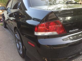

DIY: Red Out Tails (EVO VII STYLE)-0cvurvr.jpg
had some time and did mine
although the pass side is not as clear. Has a bit of haze. Going to polish them and then post some pics after I have them clear coated

DIY: Red Out Tails (EVO VII STYLE)-he6ohm6.jpg
DIY: Red Out Tails (EVO VII STYLE)-cihbe5h.jpg
back from clear coat
