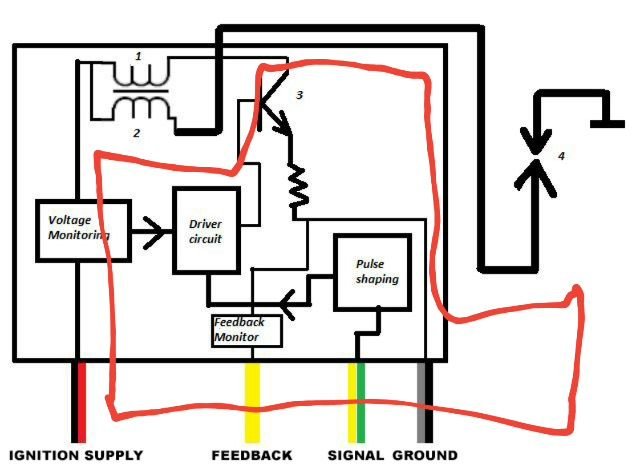

Originally Posted by 2006EvoIXer
Thinking further, the spark plug won't allow a 12V connection. So that circuit is dead. So the spark energy has to come back somehow.
Any coil connected to 12V will stay 12V. Secondary coil is not going to step up by magnetic field from coil 1 because direct connection to 12V will make coil 2 form it's own magnetic field. Think about it...
No that's what you assume it will do because you lack knowledge. Secondary winding cannot form a magnetic field as it is not connected to the ecu's power transistor, it just has the 12v supply go through it. The magnetic field is created only between the battery the ecu and the primary.

Check this animation out. FF to 3:00 mark and it shows COP (left) and evo's OEM (right) spark pathways. You may need to slow it down to see how it goes to ground.

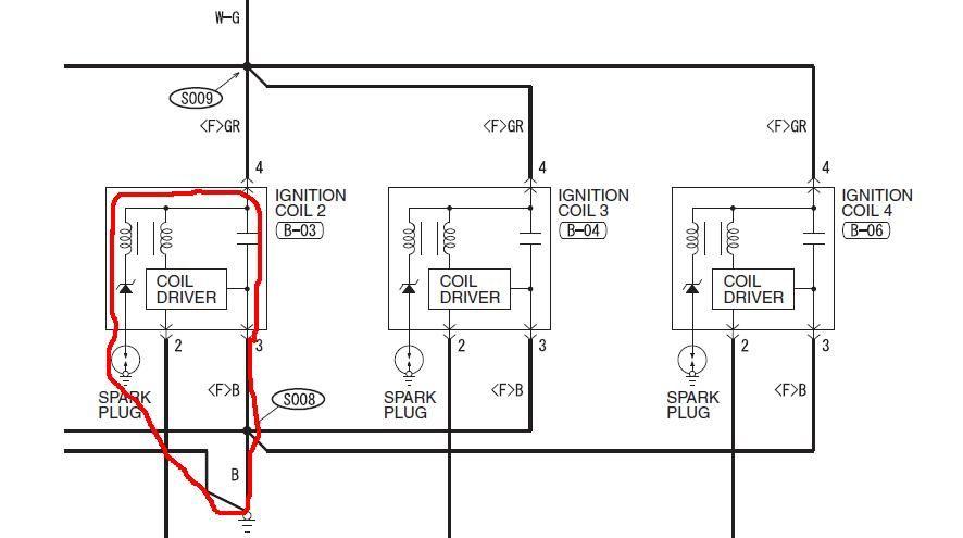

Ok I finally found a good diagram showing the coils in the configuration that the crappy diagram you guys posted tries to show but fails. It is missing critical elements, namely a bypass cap inside the coil pack itself that completes the loop...not the battery. So yah I dunno what the take away here is but I'll post the diagram when I can get to a PC.

The diagram I found is from the Evo X FSM, I need to convert it before I can upload the page because the forum doesn't support pdf's (that I know of).
There are different types of pencil coils, the toyota(denso) ones used usually to make the COP for the Evo in conjuction with the harness of the Evo 4-9 and ECU, are as I said, so different coils use different paths. I have not done any research on the matter in regards to the EVO X and its 4 pin plug coils/ and harness, but it is possible that the loop can be closed with in the coil pack.

Originally Posted by Evo8cy
The post about the oem ignition system loop is correct.
The toyota ignition coil internal diagram is also correct.
The loop on the COP system works in the same way as the stock ignition does.
The reason it does not act as an isolated closed loop system is because the feedback line or second ground is not activated but left out on the Evo
, unless one decides to activate it through an aftermarket ECU.
Also about the COP, it works best when a sequential type of ignition is used through an aftermarket ECU.
As a wasted spark type it performs at least as well as the dual output coils on the stock or aftermarket ecu.
The advantage here is that, it allows one to incorporate stronger coils than the dual output oem ones, at less than half the price of a set of quality uprated oem type units such as the Okada direct replacements for example. Even If one merely needs to refresh the ignition system, builds the COP system himself, it will cost even less than buying two brand new oem original mitsubishi dual output coils.
