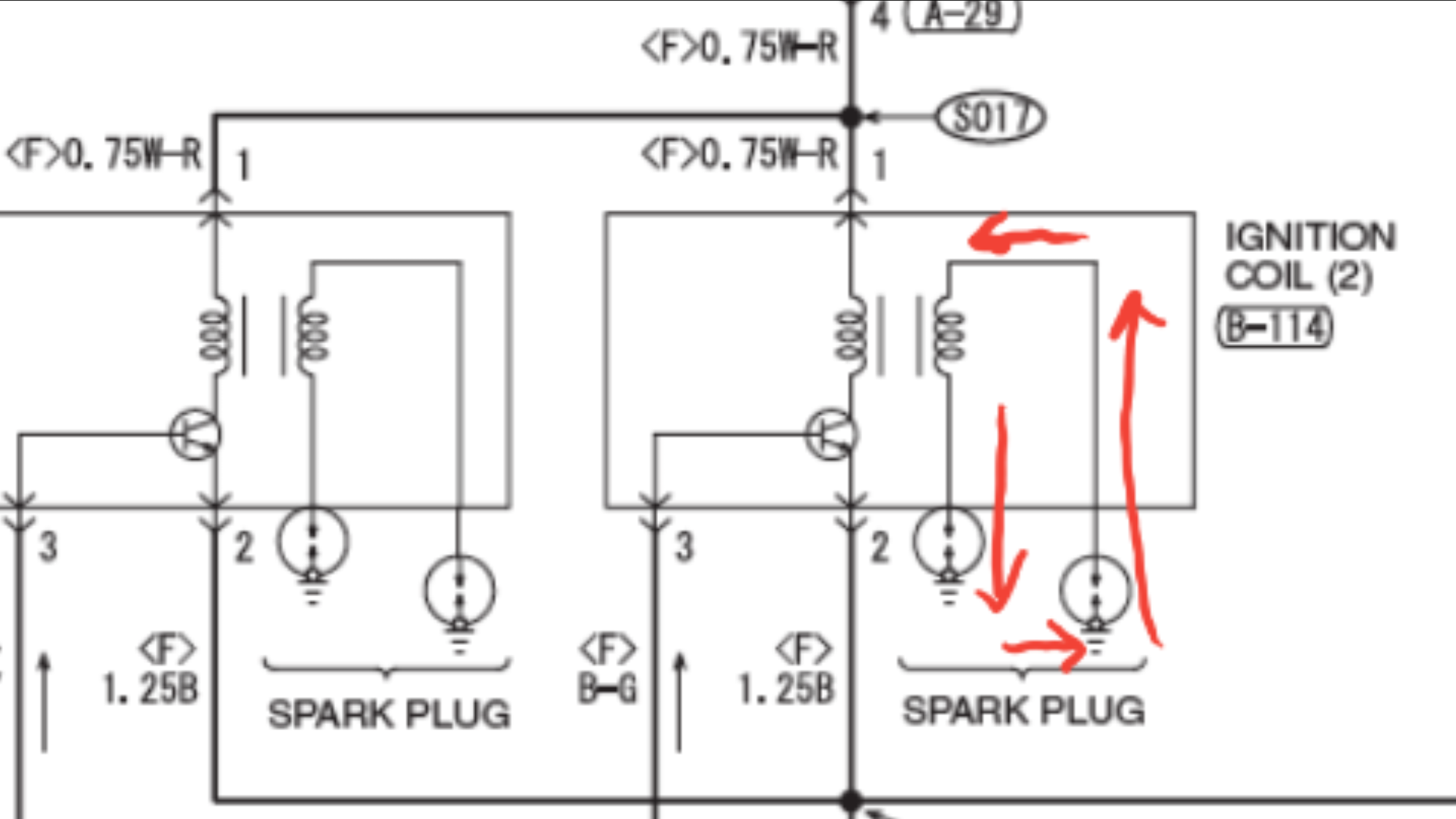

UPDATE!: I just watch a video that explains the evo's oem set up and it makes complete sense! Both spark plugs do fire! One spark plug fires from the center electrode to the ground electrode. The energy travels throught the head and fires the spark backwards from the ground electode to the center electrode!! And closes the loop. That just blew my mind!!
Spark goes to cylinder #4 spark plug, travels through head to cylinder #1 spark plug, spark backwards to center electrode, through spark plug wire back to coil!

With the COP, spark discharges into head. How does this get back to the secondary coil to close the loop?
The ECU pulls current through the primary and when the primary is fully charged the ecu shuts off the current and the collapsing field induces the voltage spike on the secondary which fires the spark plugs. The dwell time is the time it takes for the field of the primary to build up.
Old Feb 15, 2018 | 07:09 PM
  #102
Biggiesacks's Avatar
Posts: 5,690
Likes: 708
From: West Coast
The secondary is also attached to ground.

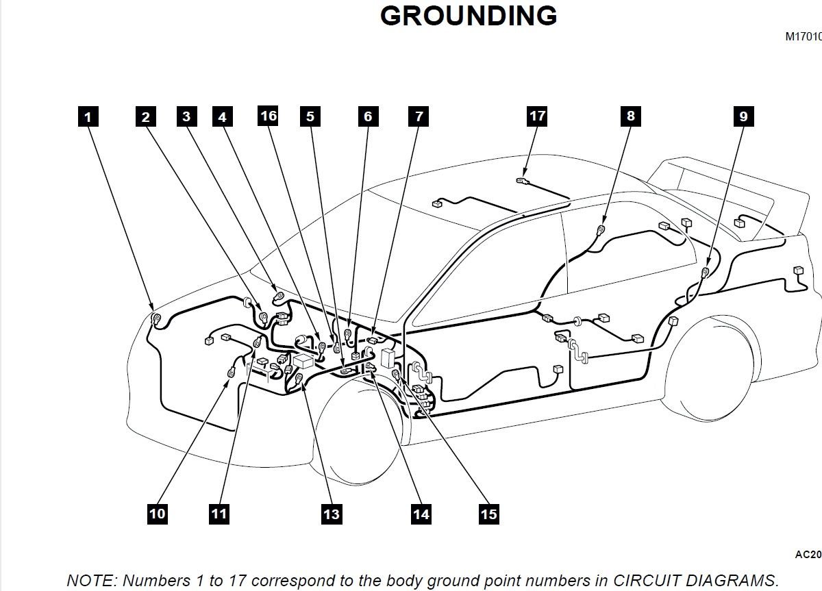

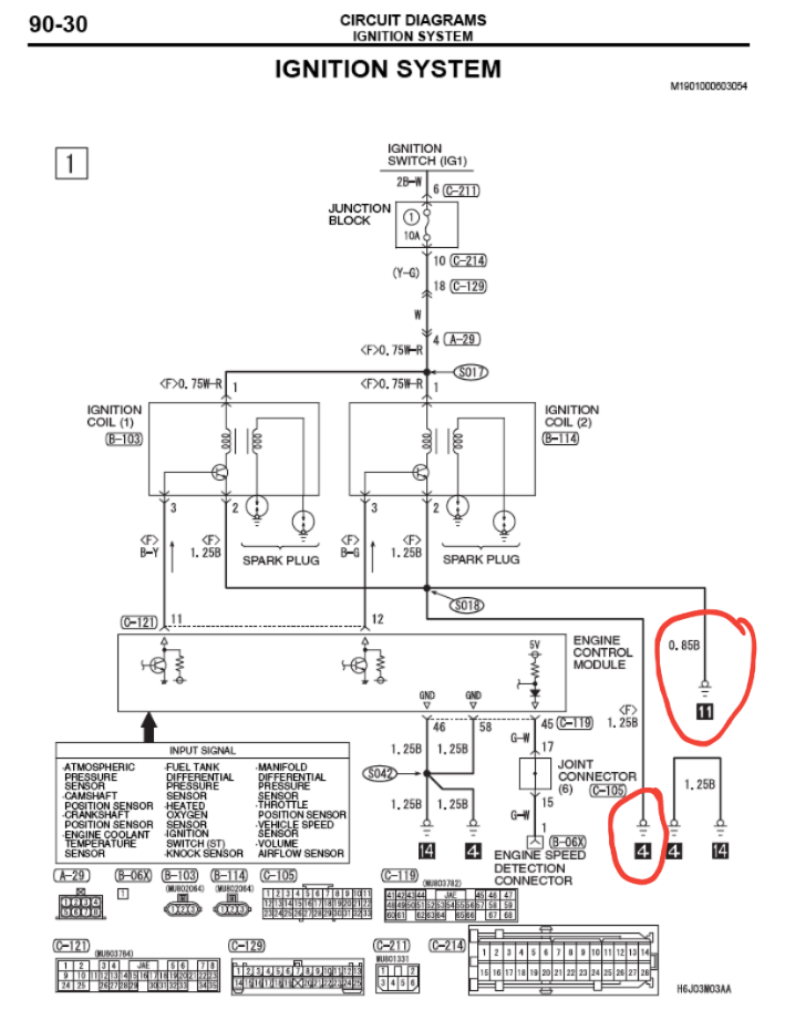

Do you know exactly where the OEM ground from both connectors are bolted to on our evo? Is it near our ecu?
I'm looking for actual locations on car of red circles:
Old Feb 16, 2018 | 10:30 AM
  #105
Posts: 5,690
Likes: 708
From: West Coast
you can see from the diagram you posted that both primary coils ground to "body point 4 and 11"
