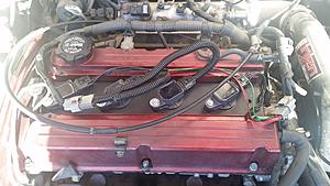

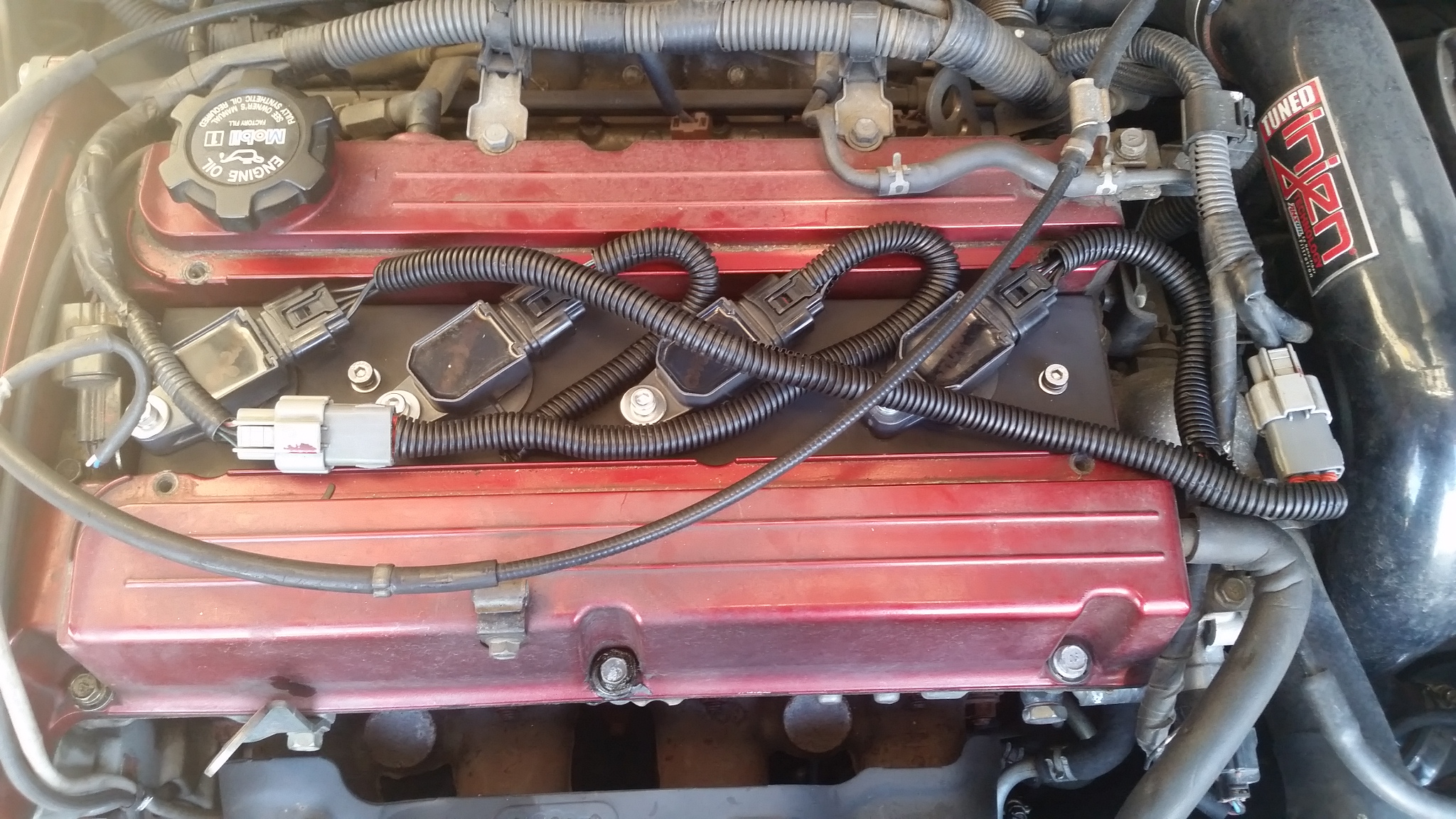

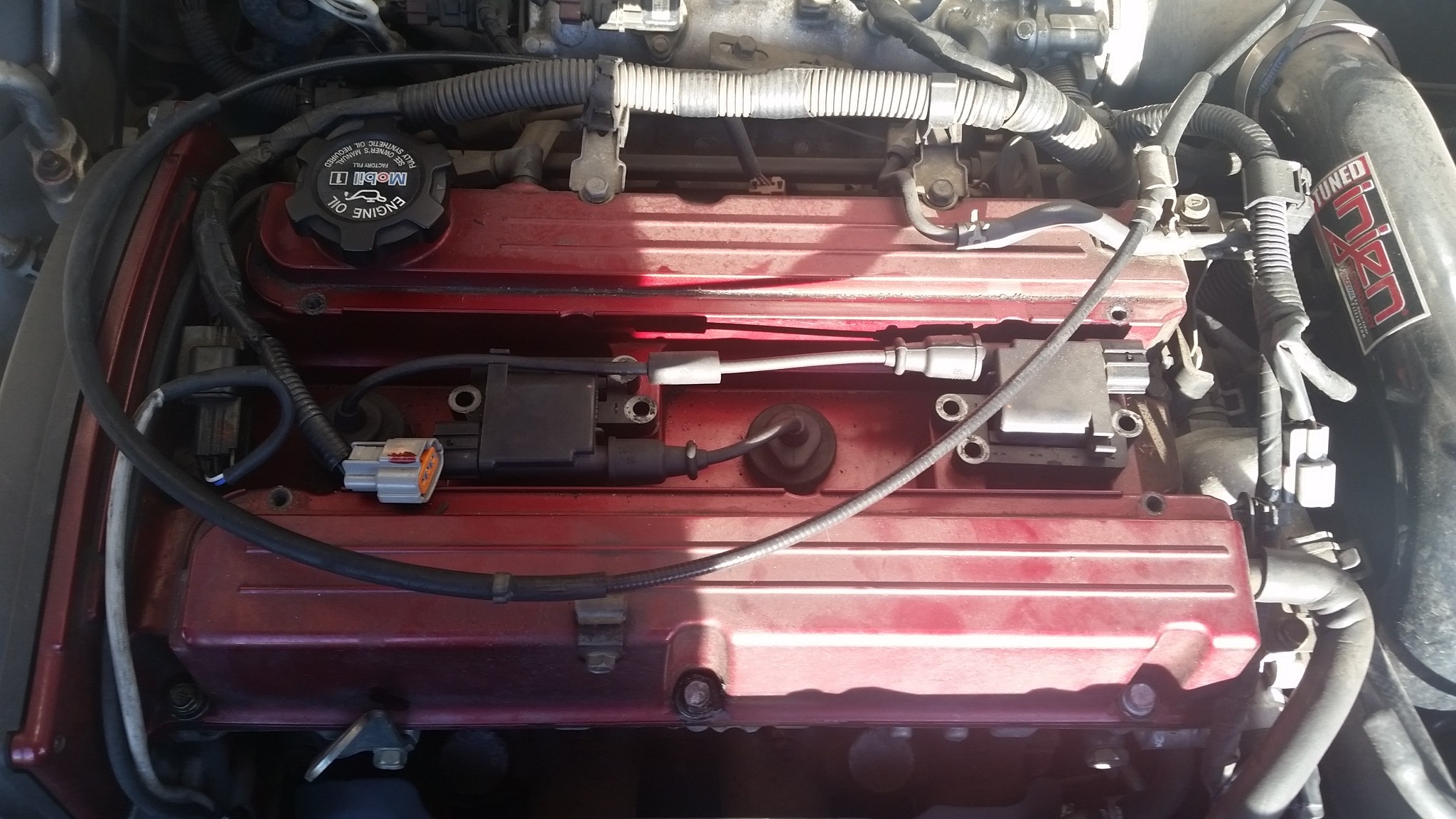

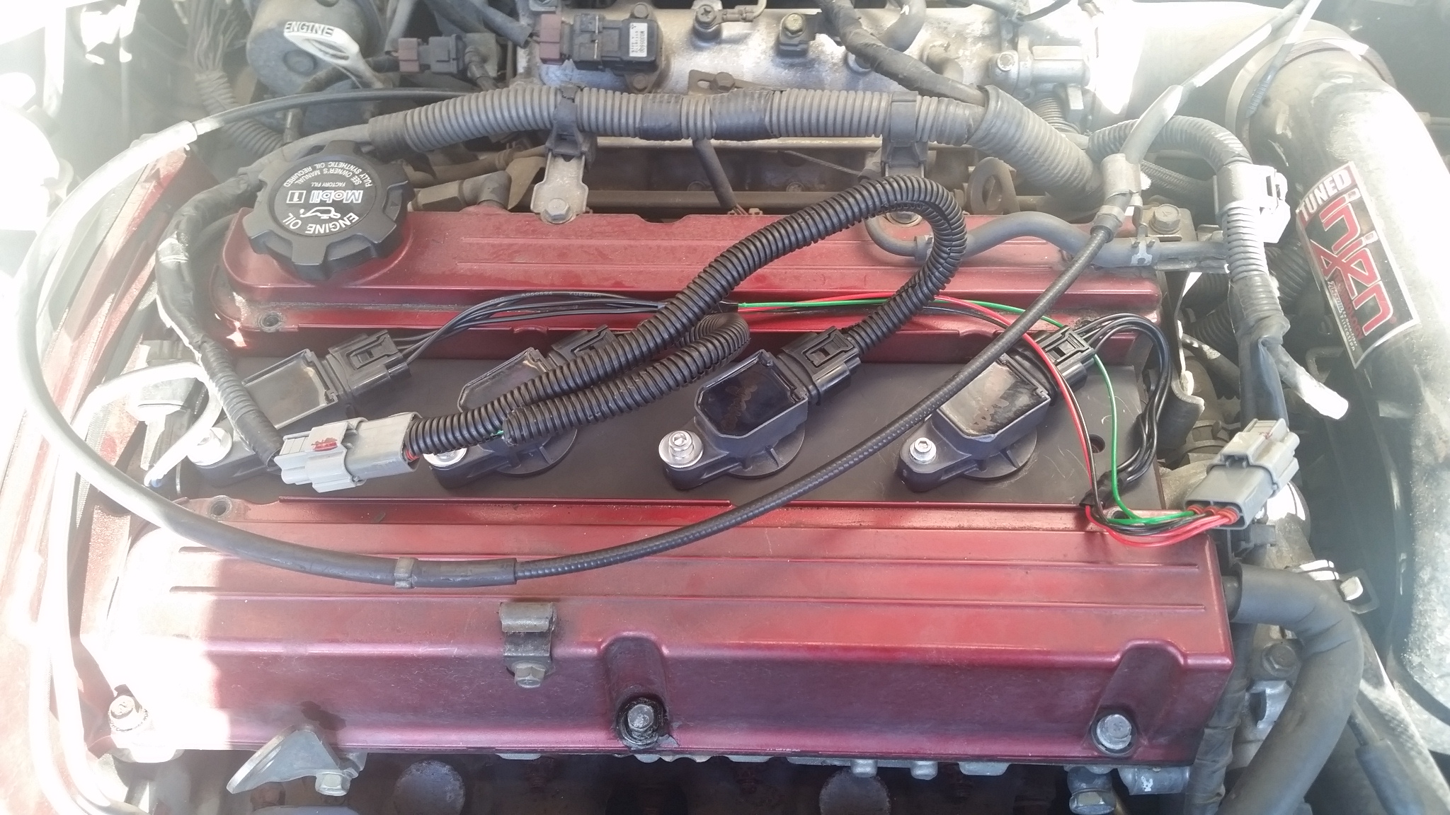

Finally sat down and put the entire COP setup together. Had to piece together some hardware for Lowes and Home Depot to get the coils mounted to the plate but it was only a few bucks extra. The binding posts provided from Spoolinup for some reason did not fit the coils I ordered them for. Oh well, I'm not complaining. I ordered the wrong sleeving from Spoolinup too and had to settle with the flex tubing. Back story is that I literally pieced together the set up individually down to the mounting plate that had to be drilled, then rattle can painted. I followed the DIY this post to the T! Crossed my fingers when I turned the key, but the Evo started right up! Now I just need to clean up the routing a little bit!
