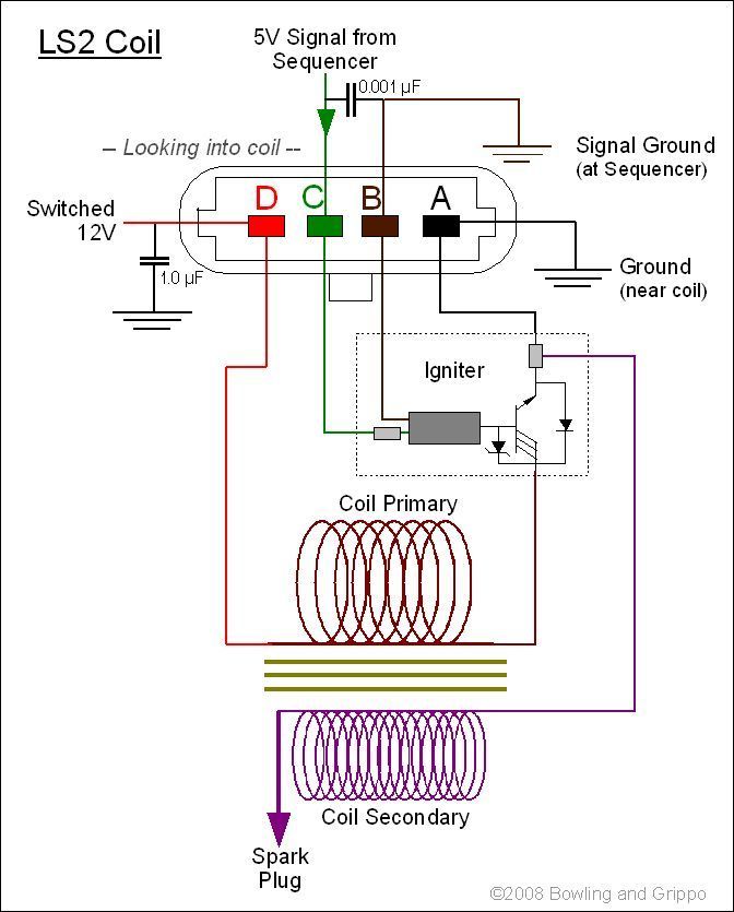

Here this at least has real electrical symbols, and as you can see the secondary is tied to ground

What you've done there is cut and pasted the incorrect diagram for LS1 / LS2 which originated from megasquirt.
The correct diagram is below.
https://www.google.co.nz/imgres?imgu...act=mrc&uact=8
The LS coils are an isolating transformer much like the wasted spark coils but different from the toyota coils which are an auto transformer.
If you don't know what an auto transformer is ...look it up on wiki.
https://en.wikipedia.org/wiki/Autotransformer
If you don't understand the basic concept, you're not in a position to give advice to others who similarly don't understand.
I don't know where it came from I just googled coil pack diagram. I will say it makes 1000 times more sense then any of the crap you post.
