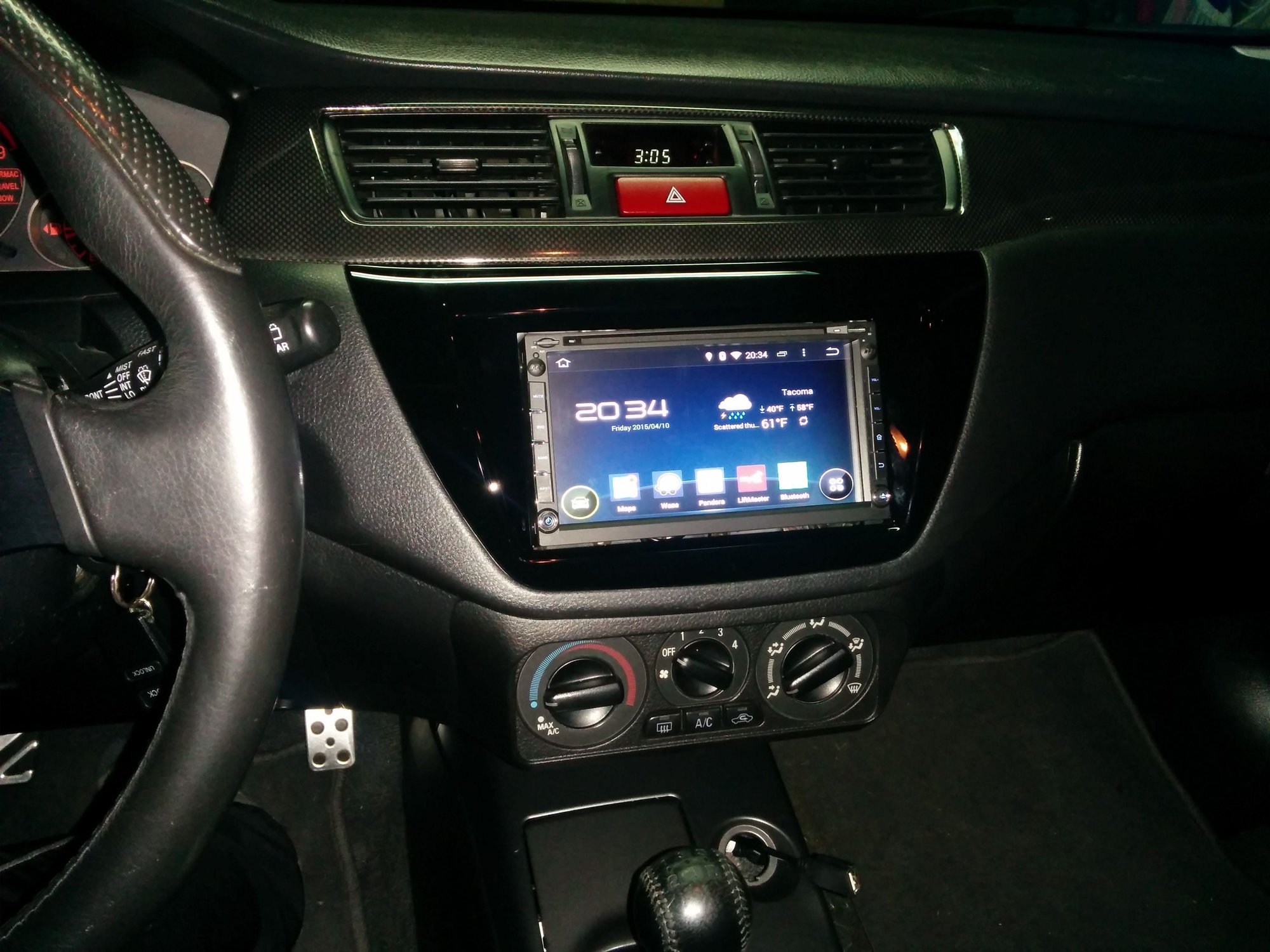

I know a lot of people have questions about the HVAC relocation like I did before I started, so I made a little video and took some pictures during the install on my Evo IX. Hope this helps someone.
Here's the video:
Here's the final product:

I successfully relocated the HVAC to the cubby hole; my question is on the temperature control cable. How did you routed that one? (the black one). Mine is routed in such a way that reaches both the gears and the controls, however my control (temperature control) is WAY to hard to use. Either the cable is to bent and doesn't work properly because of routing or it's on its last lives... any ideas?
