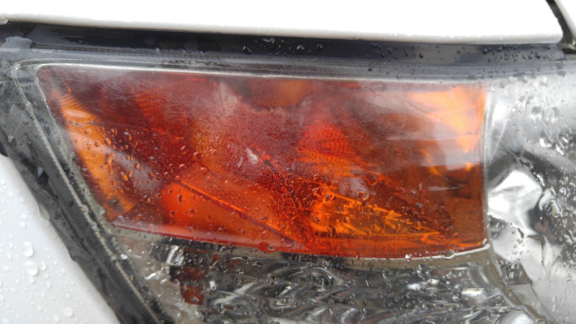

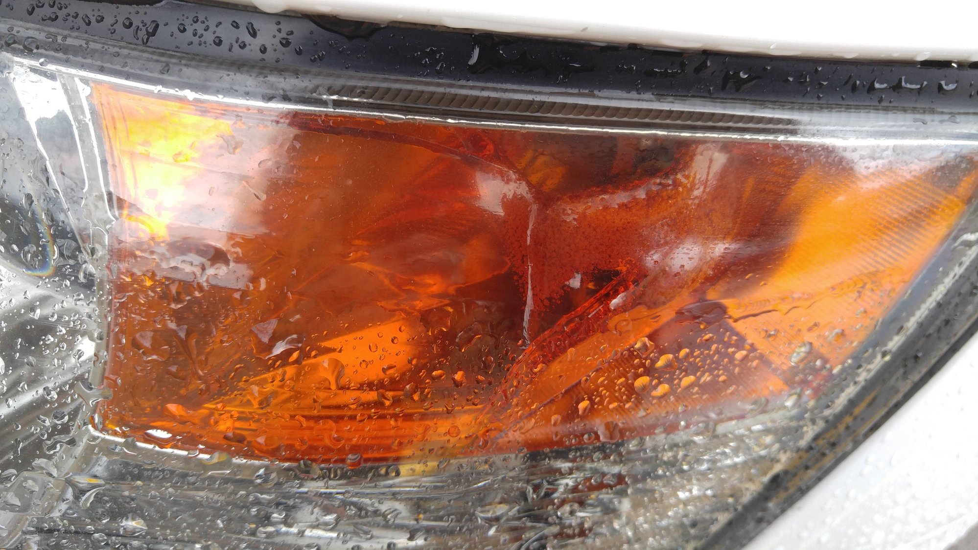

Off topic, my headlights corner parking lights are melted on the inside ( the amber part on USDM) Is there a way to replace those?
Did the bulbs melt into the plastic? Or did the amber inserts melt? Cause those r replaceable and I have a mint spare set.
The bulbs look good and intact I think just the amber
I have a spare set of those if you want them for $40 shipped. Once you remove the headlight lens the housings will come out and those pieces just snap into the housing and are fairly easy to remove/replace.
