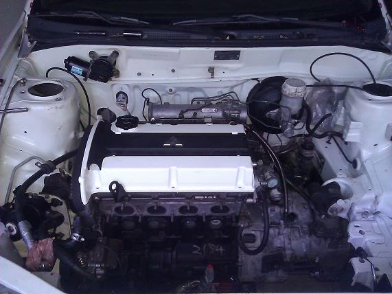

I was wanting to use the Evo 5 subframe and relocate the steering rack brackets to work with a LHD rack. Didn't quite work out.
Here the RHD subframe. Hacked off the original brackets and welded/ground down the cuts.
The rhd subframe idea didn't quite work out since the brackets needed a lot of modification to work. So I ended up using my LHD subframe and notching it to clear the tcase
A shot of the Comp Clutch 6 puck before the trans got mated. I don't think it's going to last long but at this point, I'd rather have the clutch be the weak link until I can get a built trans and tcase.
With the help of my friend Lenny, we got the swap in yesterday morning and installed the engine in his FD yesterday afternoon.
And last update for today, got the turbo manifold installed. It was a ***** getting to a few of the nuts.
