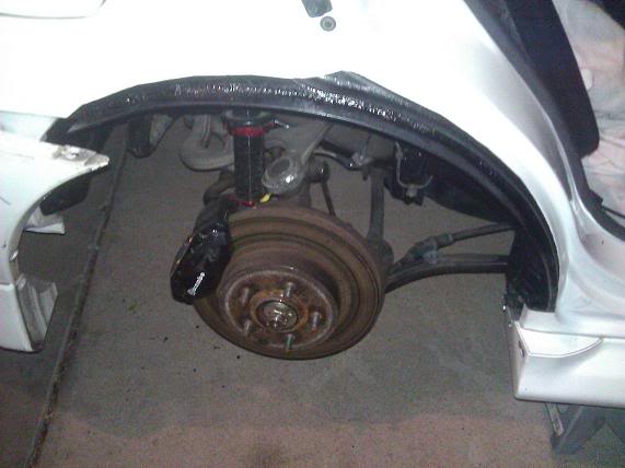

Updates for the past week.
Got the quarter panels cut and used a piece of 1.25" x 1/8" flat steel. Curved, welded, and sealed up. The used rubberized undercoating so it just looks like an extension of the wheel well.

Finally got the cleaned up, polished and waxed. Got the rear emblems put on, finished installing the rear wheel arches, and the car registered this past weekend.
