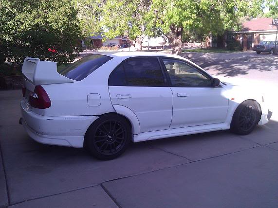

Updates for the past few days. I installed the UICP and LICP and still need to install the Tial 50mm bov and GM IAT sensor to the intercooler piping. Got all the fluids in and the car running.
Had an issue getting it started. The fuel pump wasn't getting power. After checking both fuel pump relays and the body harness, they both had power. Apparently the fuel tank harness for the Evo5 shares the same connector as the Mirage body harness, but the fuel pump power wire is ran seperately and isn't pinned to the correct connector. Couple hours later and the car fired right up.
The exhaust rattles against the driveshaft bracket so I need to weld up another hanger. Only drove down the street since it was driving me crazy.

While backing the car into the driveway, the endtank on the radiator exploded in spectacular fashion. The problem points to either a stuck t-stat, bad radiator cap, or clogged radiator. Head gasket shouldn't be an issue. I'll more than likely by a Civic half size dual-core radiator tomorrow to free up some room in the engine bay.
Soooo here she sits back in the garage. Still need to buy a catch can this week and do the rear arches. After that I'll start putting some miles on it.
