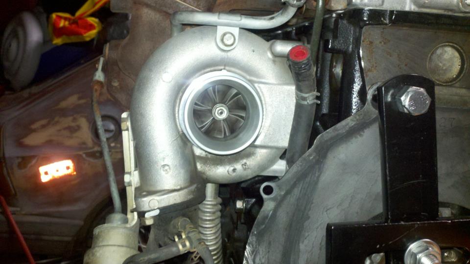

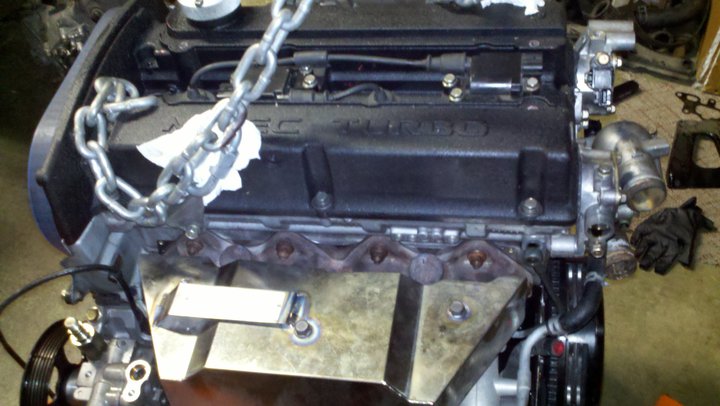

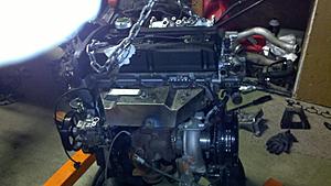

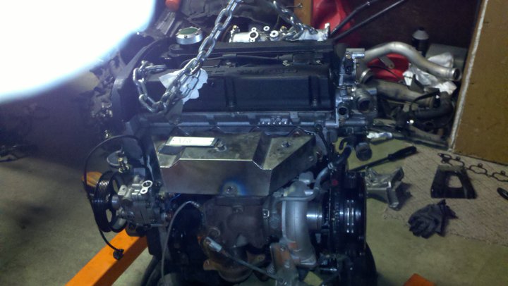

I cleaned up the motor a little bit here and I swapped on my VIII turbo and my ARC heat shield.

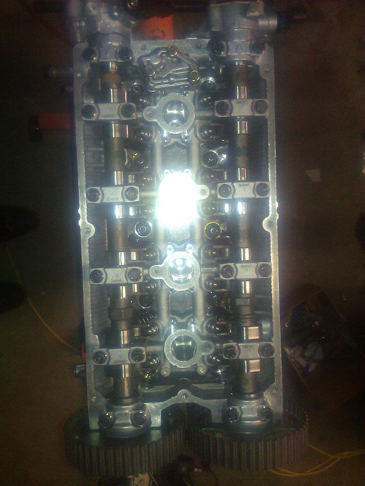

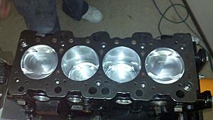

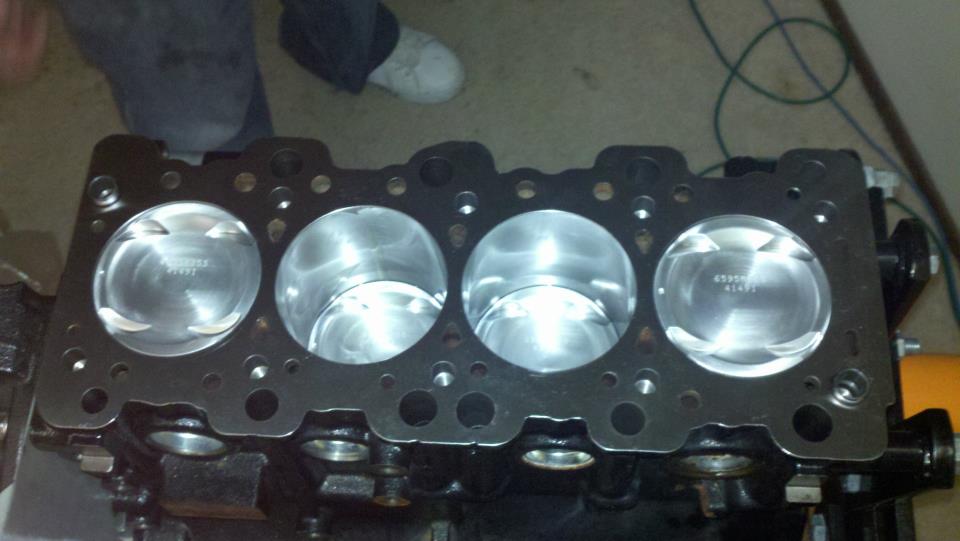

I then decided to tear the motor apart after I did a compression & leak down test. Once it was painfully obvious there were some issues with my new paper weight I purchased, I took the motor into the machine shop to be thoroughly inspected. Turned out the entire motor was destroyed and I had to rebuild the head and block. Thankfully I only had to bore the block .10 over. Weisco Pistons, Eagle rods, acl bearings etc, ams balance shaft delete, etc.. The typical stuff done, nothing too special.

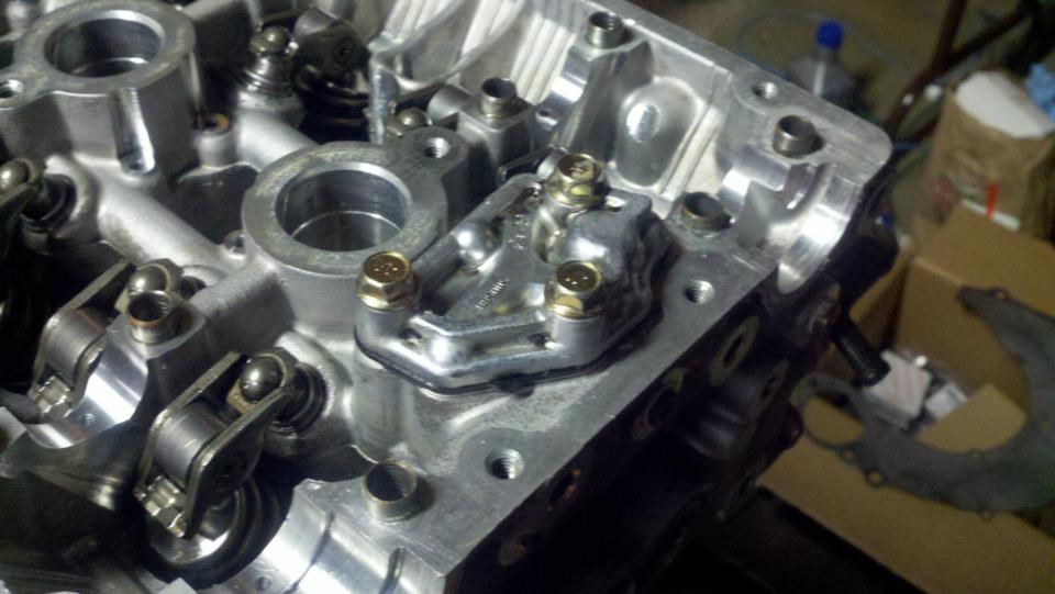

I got a light P&P on the head, 3 angle grind, beehive springs, titanium retainers, keepers, seats, and GSC 2 cams.

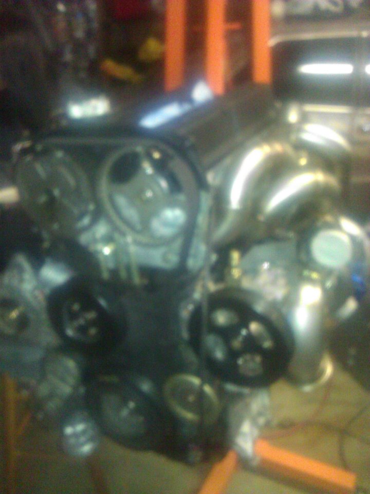

Then picked up my ETS FP HTA3582R w/ .82 ar.. I have to say ETS has been the best company I have dealt with! Period. I cannot stress how great these guys truly are! They really helped me out and cut me a killer deal
Started getting some serious work done:

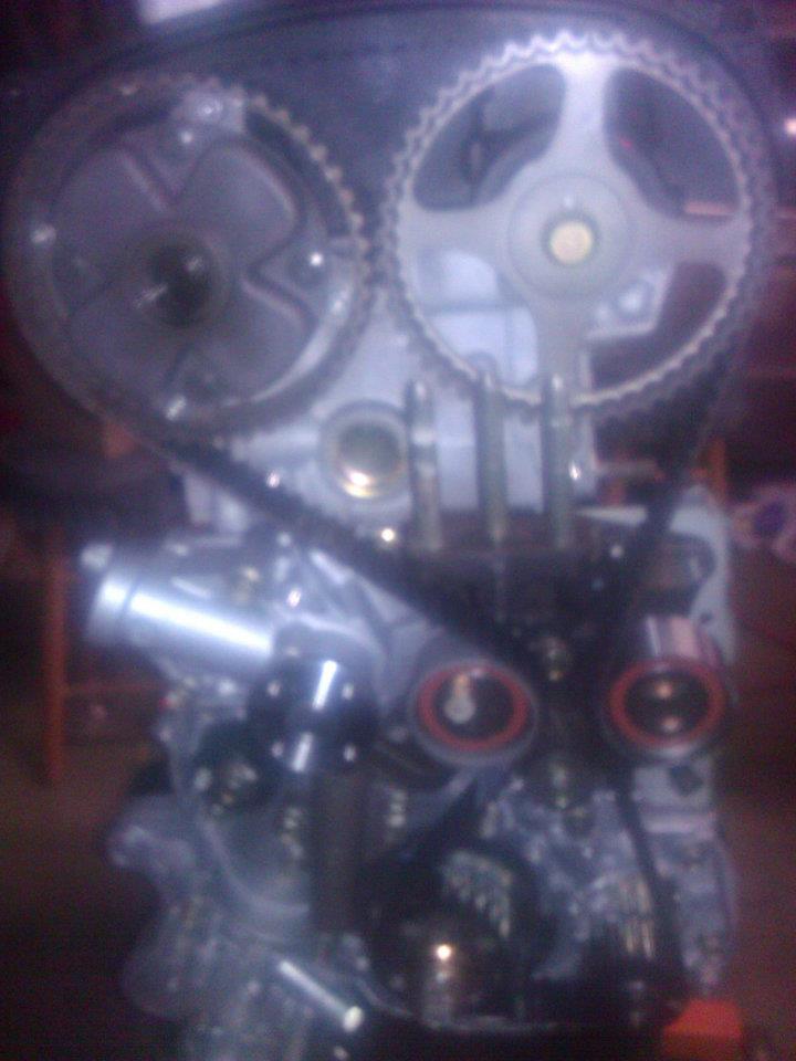

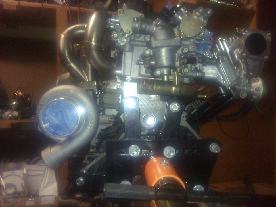

Got a lot of stuff done here too, bolted up my turbo and most of my accessories after I completed my timing

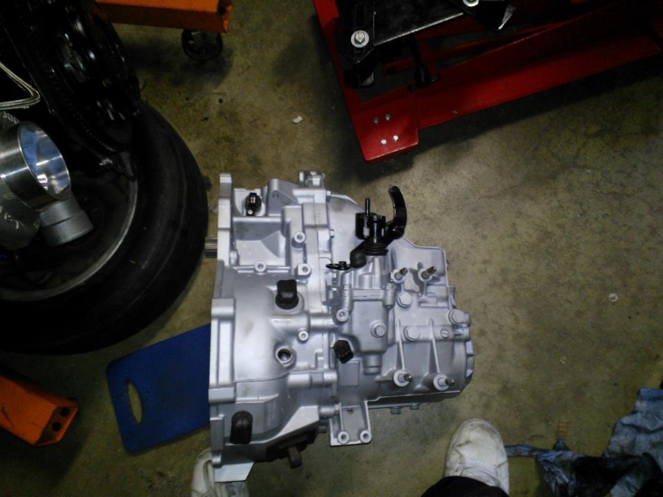

Sent in my transmission to Shep for a fully built Stage II trans and picked up a twin disk competition clutch version C, which CC claims to supports up to 750 ft-lbs. Their customer service is really nice too! The clutch pedal feels like stock and you can discard the OEM TOB which is really nice and makes the install simple!
Mating simple to do after I figured out you had to walk the transmission onto the block. Dropped the motor into my car. Took me about 35 min to get her in there.

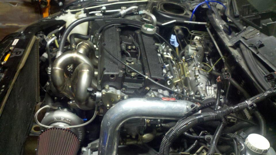

This is where I'm at as of now. The wires and tubing you see on the engine bay is for my new gauges I've installed. This is the official IC setup. It took me a little while, but I finally have everything in there! Just waiting on a few parts to start the car for the first time!!
