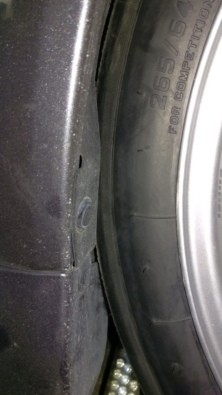

  #794
dave_evolvix's Avatar
Posts: 544
From: Champaign, IL
Jumping in here for my 2cents on fitment:
Wheels: RPF1 18x9.5 +38mm
Tires: Pirelli Racing Slick 265/645-18
Spacers: >=23mm REQUIRED up front to clear calipers. I purchased 20mm spacers as stated many times in this thread. It is NOT adequate clearance. I measured just shy of 1mm at the tightest point w/ 20mm. Brembos should have >=3mm.
Rear: Looks like I'll need to roll to be safe. Rear inner lip is deep and parallel to ground, could destroy tires IMO.
Front:
Rubs the rear fender liner/side skirt.
Front rub fixes:
Based on this thread (and others) the common solution here is to increase caster. I already have K-Mac camber/caster plates, not sure how much additional caster I can achieve and if it will be enough to stop rubbing. Below is the current (rubbing) setting. The more common fix I've seen is people using a lower control arm piece to move the wheel forward from the bottom. The Perrin PSRS added up to 1.5degree of caster allowing a very sizable move forward. That product is discontinued. The only comparable product I see is the Whiteline Anti-Lift kit, which provides only 0.5degree of additional caster. Would that be enough? Is there a better PSRS replacement out there?
K-Mac Camber/Caster plate (rubbing)
Is your EvO strickly track only? One website shows that tire diameter at 650mm which is pretty large but not as bad as I would have thought
If you moved to a traditional 265/35 that would help
Maybe you already know that. just adding my .02 as noted
