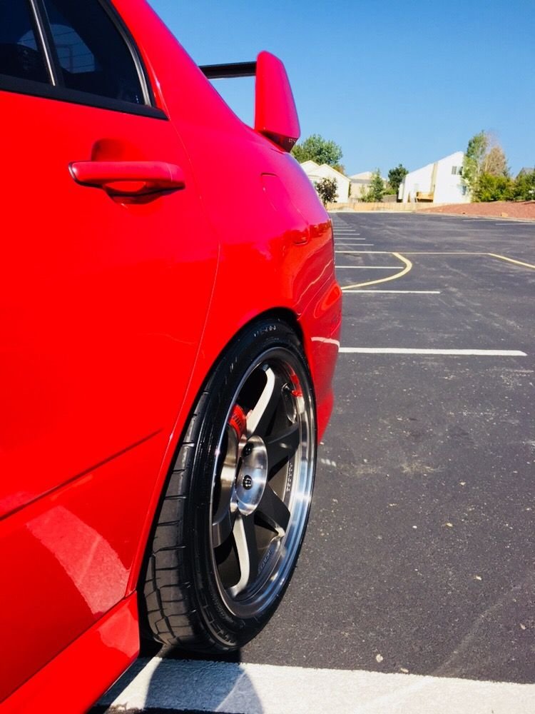

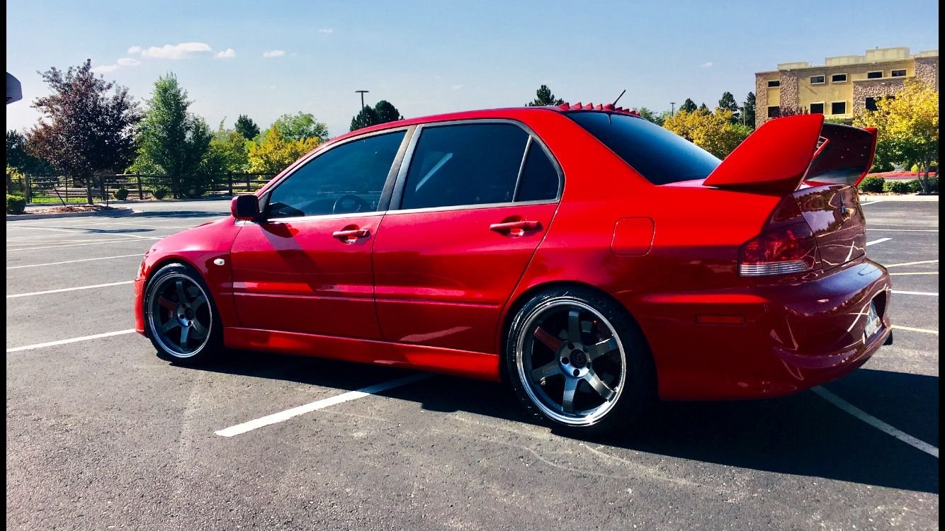

Here’s a few more shots of the 18x9.5 +22s
Had my first few rubs on some dips but overall very happy!
Excellent shot. This one makes it to my work SS.
And thanks for the honest note about the rub
Looks Great

Rubbing on both of those cars is likely the bumper bolt. Just need to relocate that. The fender is pulled enough to not rub.

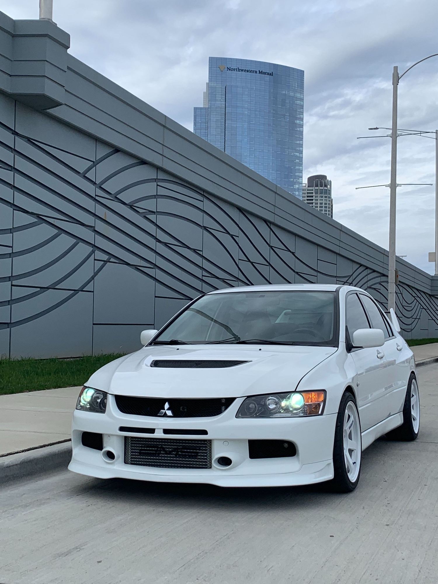

Just got my dream wheels!! This wheel was the only reason I wanted a white evo 9, so I could put white te37's on it!
18x9.5+22 255/35R18 re71r's. Rolled quarters (no pulling), relocated rear bumper mounting tab, and nothing is done up front.
