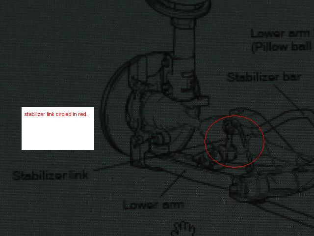

Pics and/or a parts diagram would be appreicated.....

.....it really depends on how ****ty the roads are in your area.

any better diagrams? that looks like it was pulled off a boyscout badge

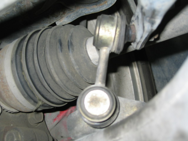

here are better pics!
this should solve the problem...so we can close this thread.

I don't understand why it would make the clunking noise? I'm not doubting you on this, but other people thought it was the spring and put that rubber tube on the top and it fixed the problem. How are we sure that this is the problem? Mine pisses me off it seems to get worse everyday.

If you get a chance have a mechanic check your stabilizer link. Once its removed try rotating it. it should be very tight if its still ok. you can also hear that clunking noise from it. try it.
