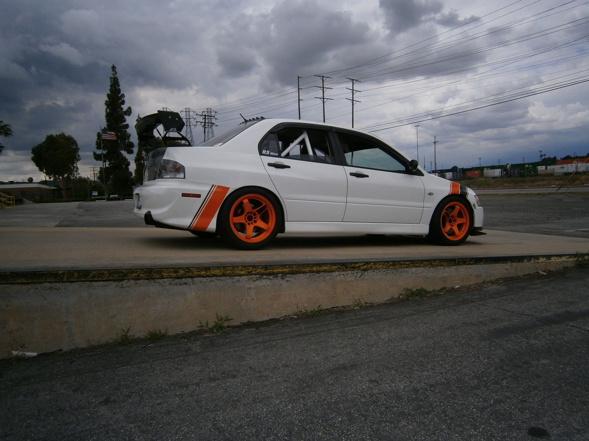

3) I've searched for pictures of 17x9.5 and 18x10 Evo IX comparisons, but I haven't had much luck. If any of you have any pictures of your Evo VIII/IX with RPF1 17x9.5 or 18x10's, could you share them with me? I'm definitely curious to see them side-by-side.
See attached pic of my ride (its in track day mode so excuse the decals) (17x9.5 +30 running Federal 265/40's. Rear fenders fully treated)

See attached pic of my ride (17x9.5 +30 running Federal 265/40's. Rear fenders fully treated)

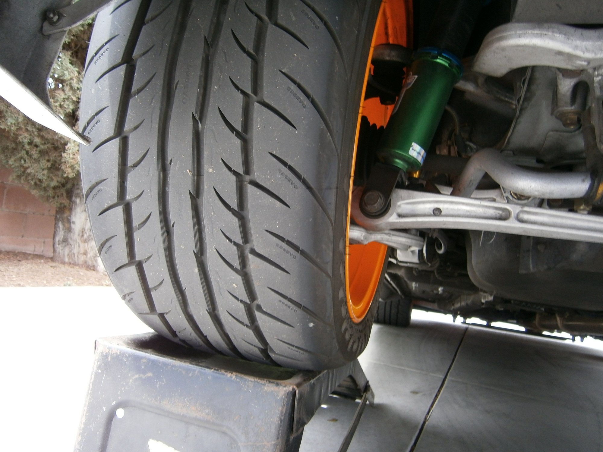

18x9.5 +35 Konig milligrams, 265/35r18 Re11's. 10mm spacer in the front to clear the strut.
Attached Thumbnails Rookie Wheel Offset Q's-photo183.jpg   Rookie Wheel Offset Q's-photo159.jpg

My car has fully rolled and slightly pulled rear fenders, the rears would not clear if the fender was untouched. Front fenders are stock, just had to coax the fenders liners out of the way with a heat gun.
Old May 17, 2016 | 09:56 AM
mrfred's Avatar
iTrader: (50)
Posts: 9,675
Likes: 132
Interesting, I have absolutely no rubbing with 17x9, +32 mm, 255s, -2.5f/-2.0f. I'm surprised another 1/2" width and next size up on tire matters that much.
Old May 17, 2016 | 10:25 AM
LetsGetThisDone's Avatar
Joined: Oct 2013
Posts: 15,973
Likes: 1,629
Well, if you have 1/4" of clearance, it won't rub, period. My package is 1/2" wider, so it takes up the 1/4" of room you have, and then some.
