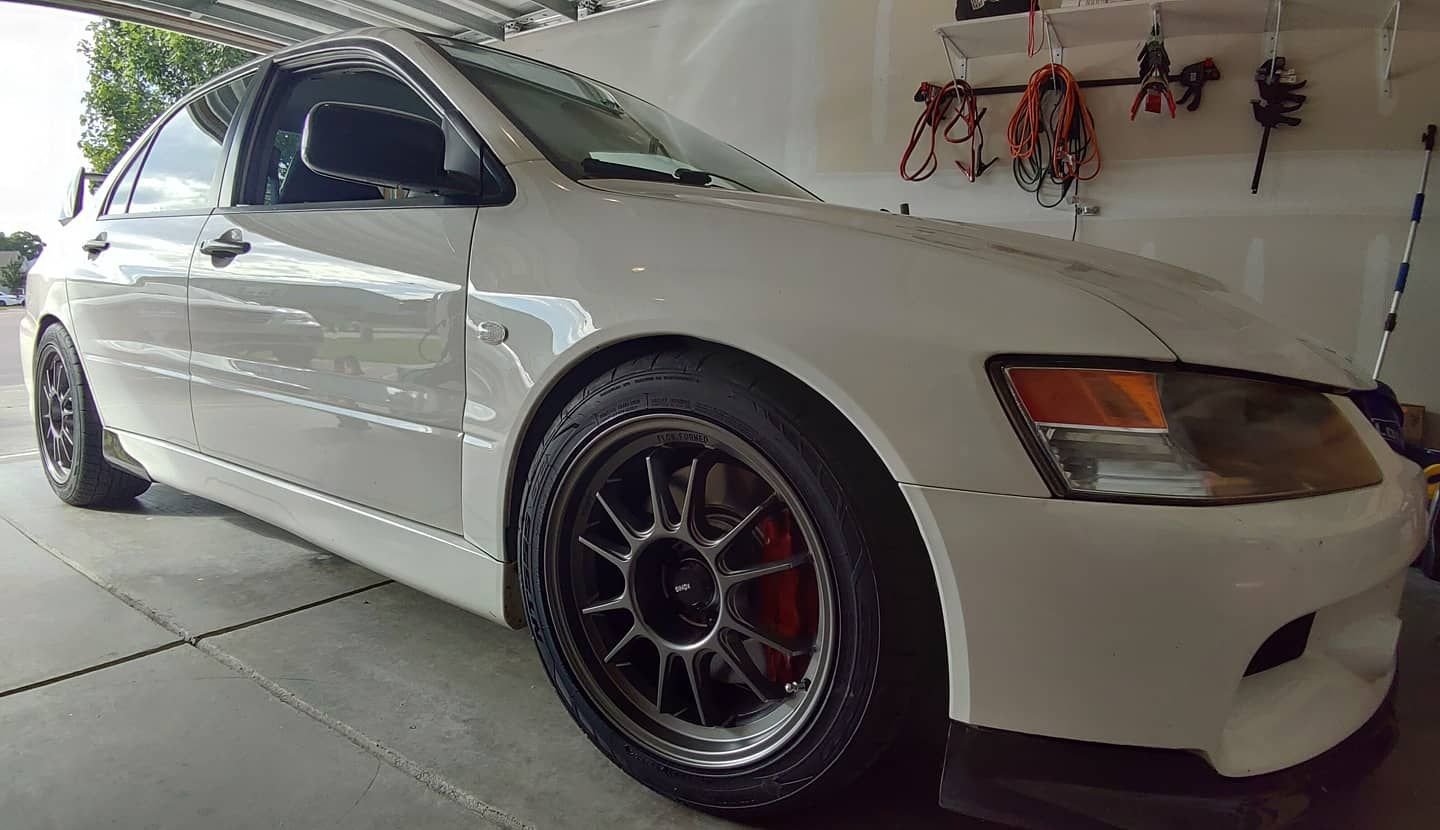

Hey guys. I was in the market for new wheels recently and figured I'd share my new setup.
​​​When I purchased my Evo IX RS, it already had Motegi MR118s in 17x8+32 on the car. I liked the way the Motegis looked, however they weigh nearly 22 lbs each. Since it's an an evo, I wanted to upgrade in both width and reduce weight.
I spent countless hours searching the forums, Facebook, Instagram and Google images. The two that caught my eye were the Wedssport TC105X in 17x9.5+32 , or the Konig Hypergrams in 17x9+25. I found only a few examples of these wheels on an Evo 8/9, and most of them were in 18s rather than 17s.
Ultimately, I decided to go with the Konig Hypergrams as the price of the Hypergrams were less than half of the TC105Xs ($170 compared to $450) , and weighed only about ~2 lbs more per wheel. I also upgraded from 235/45/17 BF Goodrich Comp2A/S to 255/40/17s Nitto NT555 G2s.

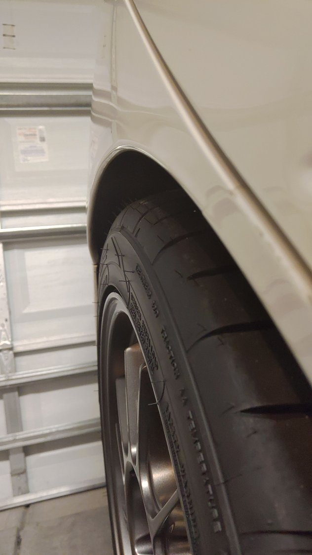

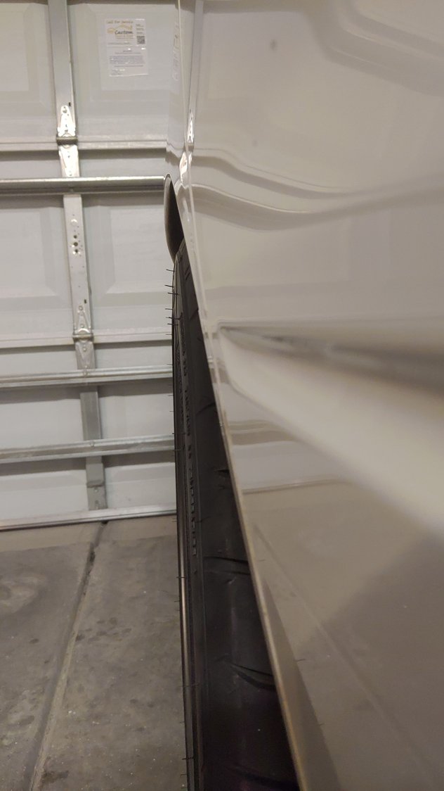

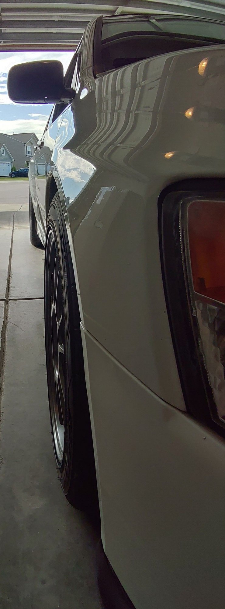

I have to admit, they look real good. I was worried a little bit fitment because I only found 1 example on the forums of the Konig Hypergrams with a +25. The post mentioned there was slight poke and the car also had some camber. All the other posts were in +35 where a 3mm spacer is needed to clear the front calipers. In addition, my car has an unknown brand lowering kit. If the wheels didn't fit, I would be S.O.L.
I gotta say, that's pretty flush and looks real nice compared to the big gap that was there with the Motegis. There's no rubbing, even at full lock. Anyway, thanks for reading, I hope if there's anyone looking for new wheels in the future, that this information helps, and the reader may consider the Konig Hypergrams.

Looks excellent. I like the look for sure. That wheel is super nice & has an aggressive offset at +25. No rub in rear w/the 255's? Surely the rear fender must be rolled?

I went to go check since I did not get the fenders rolled. The rear fender has a slight roll on it, but there looks to be enough clearance even without a roll, but I could be wrong

Did they require any spacers? Wheels looks great nice evo!

I did not use any spacers at all. The only thing I needed was hub centric rings that are really cheap. Based on previous posts I was able to find, the +35 offset does require a 3mm spacer.
