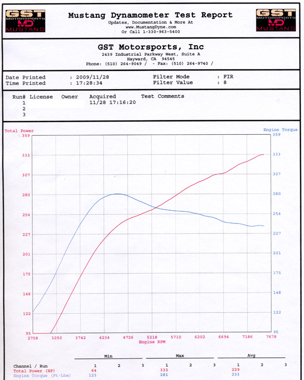

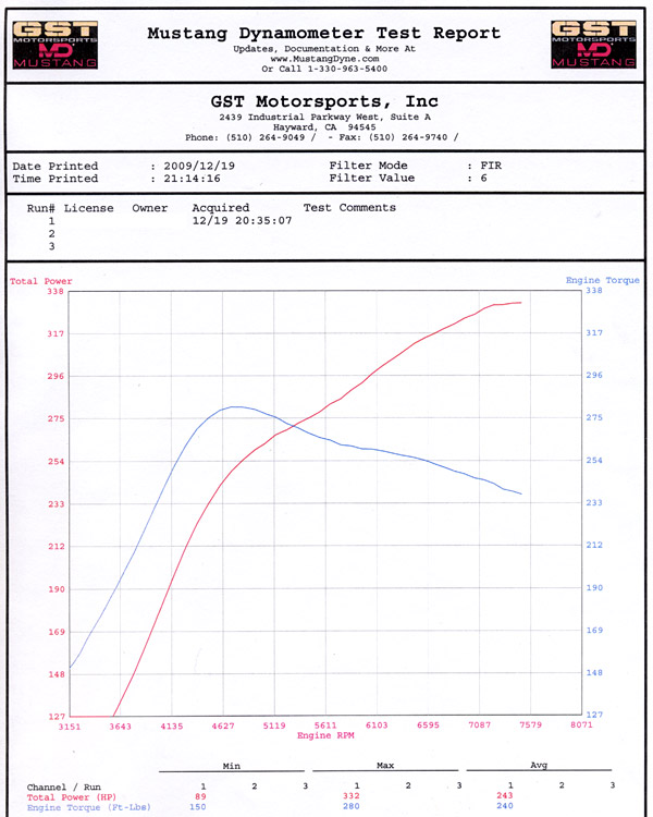

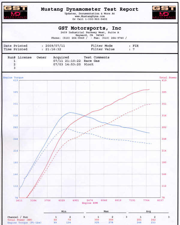

Yes I see this on pretty much all the Evo 10's with larger than stock turbos and stock cams with bigger boost. Might be because of the way the 4B11 is with stock cams and rod ratio, etc
I also am a bit more mild in the peak torque area on Evo 10 E85 tunes as my customers like their rods and pistons to stay in factory configuration.
Examples:
2008 Evo 10 GSR, Dom 2.0, Stock cams, E85, 29psi:
2008 Evo 10 MR, Dom 2.0, stock cams, 91 oct, 24psi:
2008 Evo 10 MR, Dom 2.0, stock cams, 91 oct, 24.5psi:
2008 Evo 10 MR, Dom 2.0, Kelford Cams, 91 oct, 24psi:
2008 Evo 10 GSR, FPred, stock cams, 91, 24.5psi:
2008 Evo 10 GSR, GT3076, stock cams, 91 and 110 oct, 24 and 29 psi:

WOW.... 91 Octane has that effect!?!

Which effect are you referring to?

Sorry.. I guess running higher boost and the way TQ drops off... Just my untrained eye observation. I guess I can see the difference between 91 and E85.

Yes the 91 tunes show how the torque drops off right after peak torque and the E85 higher boost tunes show how the torque is sustained for much longer. Remember horsepower is a equation off torque.
I have yet to see a "factory defective" piston losing a chunk of itself or a vented block on a 4B11 and I have tuned Evo 10's that have been used on track, circuit and street since they where introduced here (knock on wood) and, as far as I know, the first person to tune a Evo 10 on E85 in the United States.
