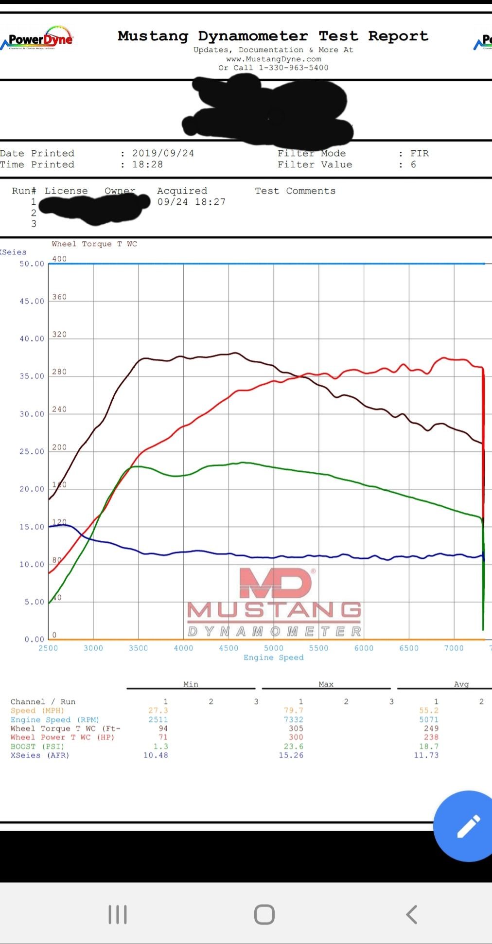

1st dyno tune
14' GSR 45k miles.
MAP UICP
Cosworth drop in filter
Grimspeed 3 port
Tomei test pipe
Tomei cat-back
91 octane
Looking for suggestions for possible next direction regarding power mods. I currently have a 4" Sheepy FMIC, MAP lower pipe and ANSU 330 fuel pump not installed. E85 is readily available in my area.
Old Oct 21, 2019 | 04:37 PM
RazorLab's Avatar
Posts: 14,094
Likes: 1,093
From: Mid-Hudson, NY
Seems about right if it's a proper reading mustang dyno. If you have E85 readily available, do that and never look back. It will do 340-370whp on that same dyno
Old Oct 23, 2019 | 08:32 AM
Metal_AF's Avatar
Joined: Aug 2018
Posts: 123
Likes: 21
From: Ohio
I second this. e85 is great bang for your buck. Run a flex tune so you don't have to deal with multiple maps.
Old Oct 23, 2019 | 09:13 AM
zeRep85RA's Avatar
Joined: Dec 2010
Posts: 185
Likes: 10
From: Riverside, CA
Another +1 for e85
z
e
R
e
p
Old Oct 23, 2019 | 10:28 PM
G20's Avatar
G20
Posts: 1,060
Likes: 14
From: Orange County, CA
I did that e85 and never look back.
Old Oct 24, 2019 | 10:02 AM
4G63Rules's Avatar
Joined: May 2005
Posts: 562
Likes: 24
From: Florida
You will also need injectors as well if you plan on running E-85. Check with your tuner to see which ones he recommends. Most tuners have injectors they prefer.

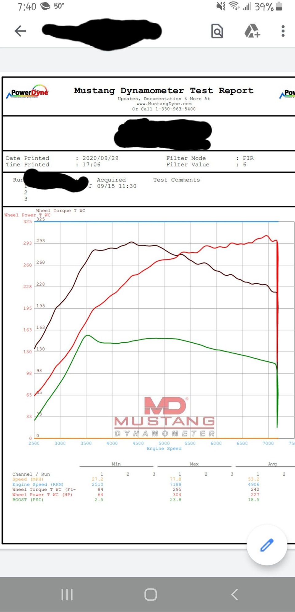

Old Sep 30, 2020 | 07:24 AM
GeminiEvo's Avatar
Joined: Mar 2016
Posts: 47
From: Minnesota
Update
Additions:
Map intake
Map licp
Sheepey fmic
Kozmic catch can
Conclusion:
Gained .2psi of boost, 4hp and a loss of 10tq. Maybe even loss of spool. Hard for me to tell. Converting to E85 in the spring.

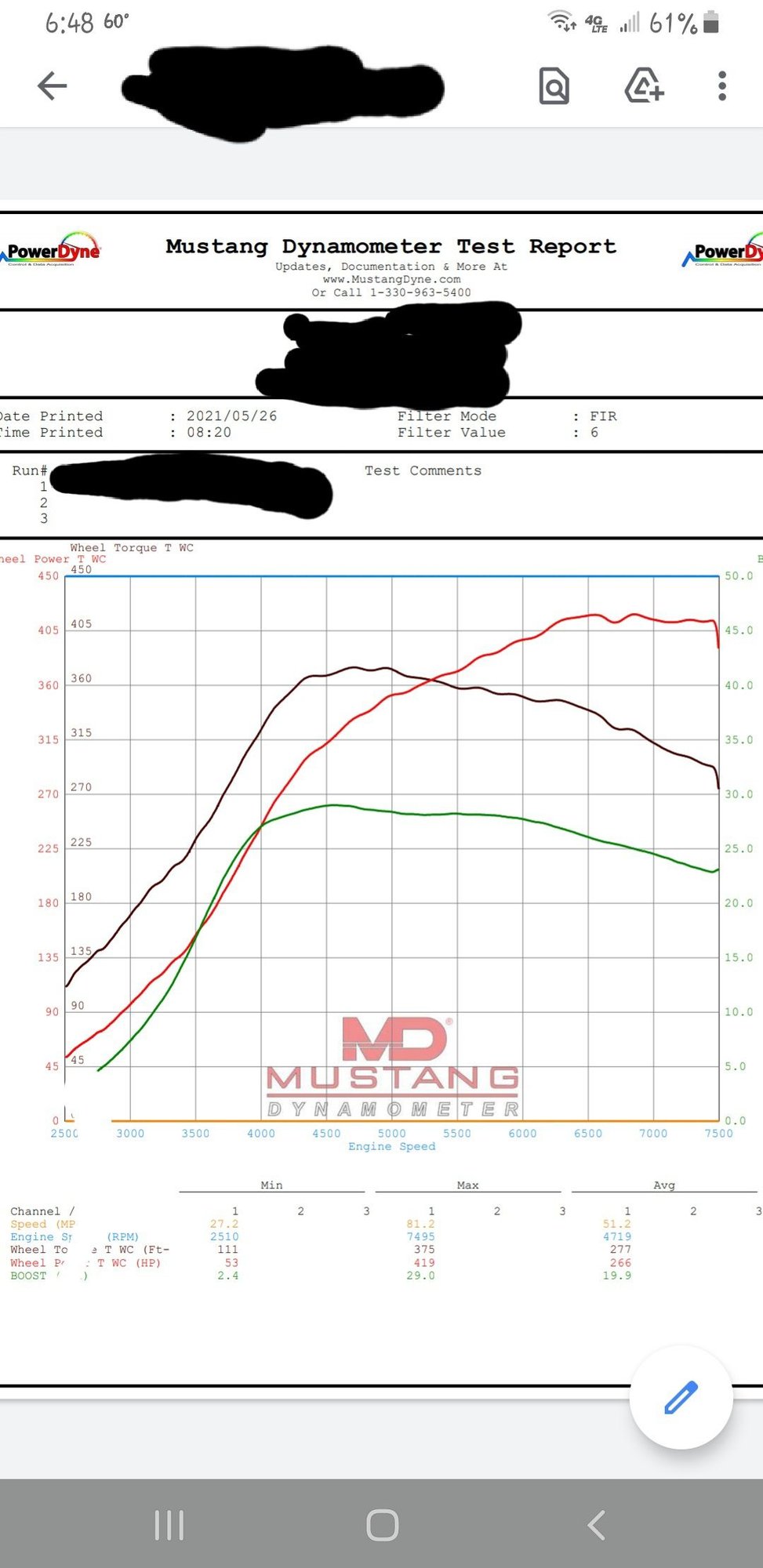

Old May 26, 2021 | 05:01 PM
GeminiEvo's Avatar
Joined: Mar 2016
Posts: 47
From: Minnesota
Update
Additions:
FIC 1200cc injectors
DW300 fuel pump
Tomei downpipe
MAP cast manifold
Kelford 214-A cams
MHI 18k turbo
E-85
Old May 26, 2021 | 05:15 PM
RazorLab's Avatar
Posts: 14,094
Likes: 1,093
Nice update! The 18k is such a great street turbo
