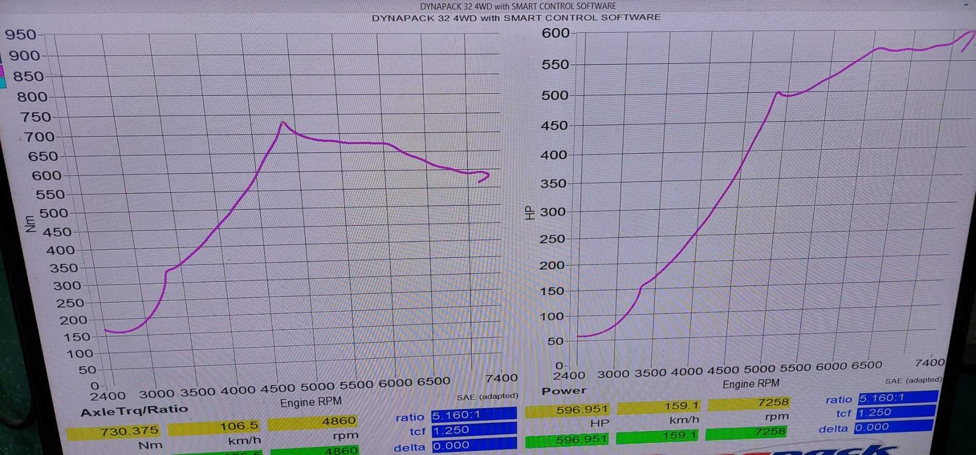

Hi using a stock block with supporting mods. Tuner thought mine was a built hks stroker kit and set at 29-30psi turbo. When collecting, he told me your engine builder is great and the tuning perform very well.... my face changed and told him mine was a stock block. His face and my face
Can this hp be acceptable for my stock block. My engine is a 2013 fairly new low mileage engine. Black valve cover with the new timing chain.
Supporting mods with stock engine
Do note this is on dynapack crank dyno with 1.25tcf. So my estimate is 470whp? Is this consider a good tune or a safe tune or daily drive? This was tuned on pump gas Shell Vpower

That torque figure is 530ftlbs. Even with the 1.25cf, thats still ~430ftlbs. I would not call this safe.
that's what I thought so too. Will inform tuner to tune it down
