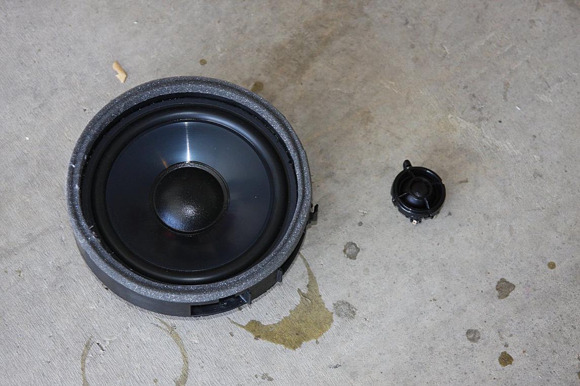

Question: do you have a pic of the stock rockford speakers? I'm curious what they're made of. Cheap paper, or polypropolene?
Old Jun 1, 2009 | 12:13 PM
c_reber's Avatar
Joined: Nov 2006
Posts: 481
From: Vegas
I have a pic of the stocks around here someplace. Let me go find it... From what I remember, the magnet was decent sized, and I think it was a rubber surround, so not horrible, but pretty bad
OK here ya go:
Attached Thumbnails Replaced Factory Amp :) Wow..-img_6045_1200x800.jpg

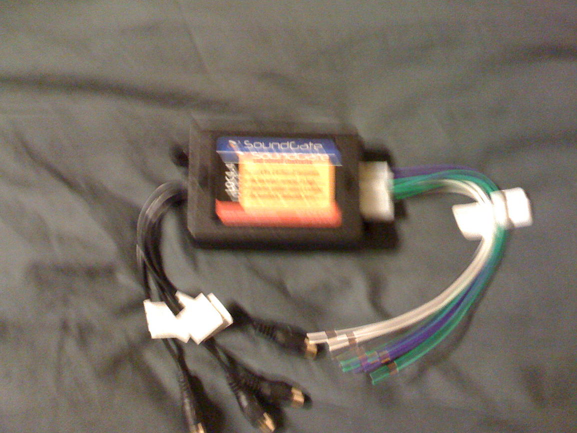

All I added was a line level converter to send signal to my amp 4 channel for front and rear.. used the pass throu for the sub amp with a line level to control the base..
here is the high to low 4 channel adapter i used.
Replaced Factory Amp :) Wow..-img_0095.jpg
Yes Nav works, sterring wheel controls and bt..

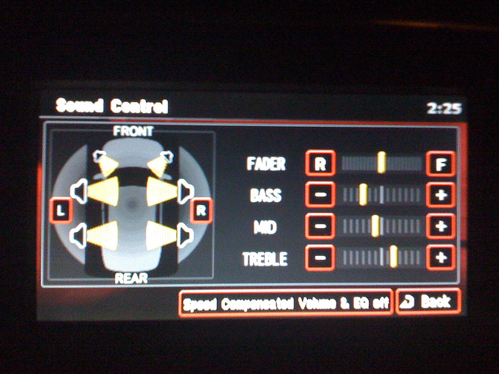

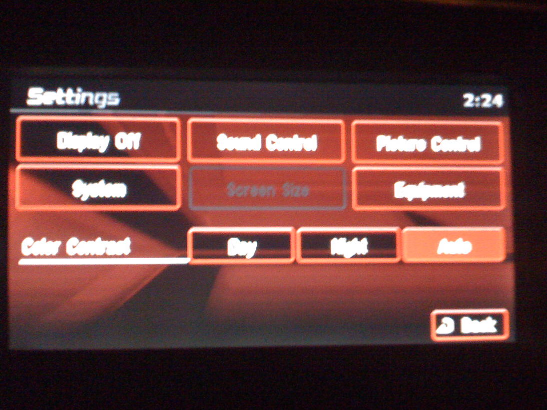

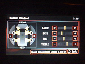

Yea and one meun that had the music type and dsp setting but who cares it sound way better
when you hit set it goes to this screen
Replaced Factory Amp :) Wow..-img_0092.jpg
To this when you hit the sound menu so there is one screen missing here
notice the punch level control missing.. and the sub graph in the trunk
Replaced Factory Amp :) Wow..-img_0093.jpg
