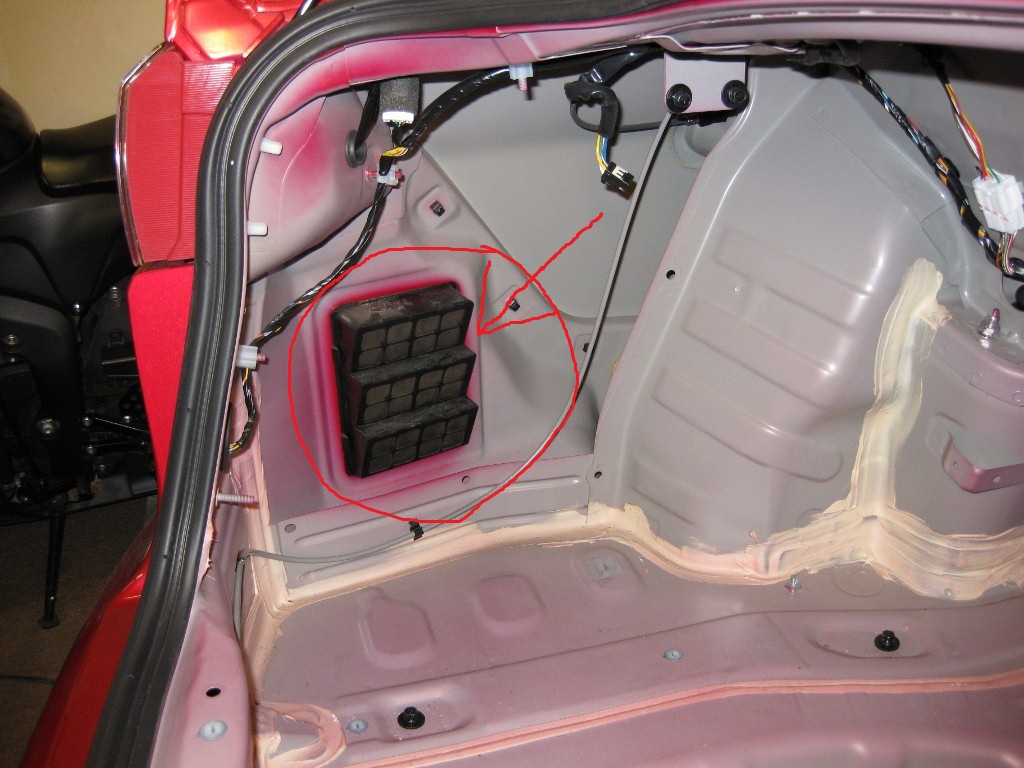

I want to know what this in this picture. The Black air filter looking thing near the center of the picture on the side of the trunk. It's only on that side of the car.
