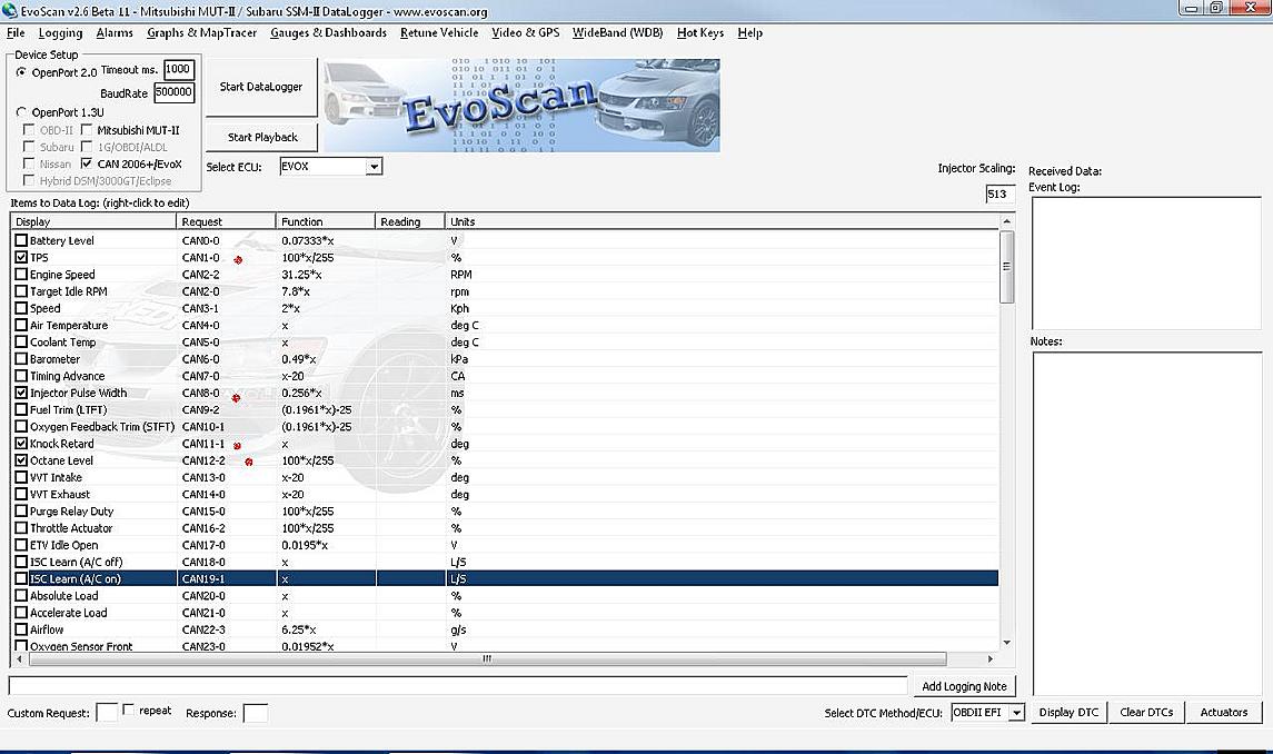

Ahh, I guess editing from within EVOSCAN corrupts the XML file somehow. If I start with a fresh Data.xml and make the edits manually, then it saves and works fine. I bet I missed that small fact somewhere in this thread.

Interesting problem for me. Once I make changes to my data.xml file, my item to log screen, where I can selected parameters, no longer shows up regardless of what "ECU" I select less the EFI choice.
I even went as far as to reload evoscan and had the same issue. Basically a blank screen.
Yeah, that's the same for everyone. If you want to edit the xml, you have to edit it in wordpad or something. Also, if you want to restore your previous data, grab the data.xml from the 2.6 beta update and put it into the install folder.

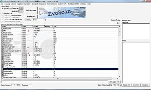

Ive been playing around with Evoscan and my datalogs miss patches ? do i need to change some settings or something. I also changed around Knock to 11-1, few other things that i got of this topic but my logs dont look right, showing 18* knock retard.
Could this be real? :S i have 3" catback and HKS panel filter on 98RON.
Acer Laptop: T7300 @ 2ghz with 2gig ram, XP with SP3.
Any help would be greatly appreciated.
Dean
Dean
I don't see 18 anywhere... I see 8, which is OK. Try to minimize this value. It is indeed the correct knock sum/count. I've gotten my own tune down to a max of 1-2 counts.

ah duno where i saw 18, but theres few that say
LogID LogEntrySeconds TPS RPM KnockRetard
36 5/8/2009 55:22.8 2.65926 14.90 843.75 14 0 13
See the 13 one, is that 13 counts ?

I don't understand your log..... were you just free reving the motor? I don't see any areas that you actually went WOT.
Nope was not free reving.
LogID 975 till 1125 i think.
Ill try get better ones tomorrow.
