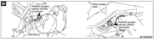

Well, since nobody offered any suggestions, I unplugged the Rear O2 Sensor Harness.
In case anyone else is having issues or wants to do this, I've attached a diagram. The sensor harness is under the passenger seat. If you move it all the way back, there is a flap cut in the carpet that you can see the grommet that the O2 wire goes through. The harness is visible there.
I'll report back if the CEL ever comes on again.
