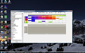

Heres a screen shot of it for the OP. For everyone else, what does the chart below mean? I don't understand the values in the cells.

ok sorry guys. this is what map tracer looks like when its working properly. i clicked on my external AFR's so you guys can see what it looks like. as you can see at WOT i'm hitting the 260 loads and barely going into the 280's. maptracer will only let you click on one item at a time but it's **** cuz it shows you exactly what you're hitting and when you're hitting it. Let me know if you guys have any questions.
