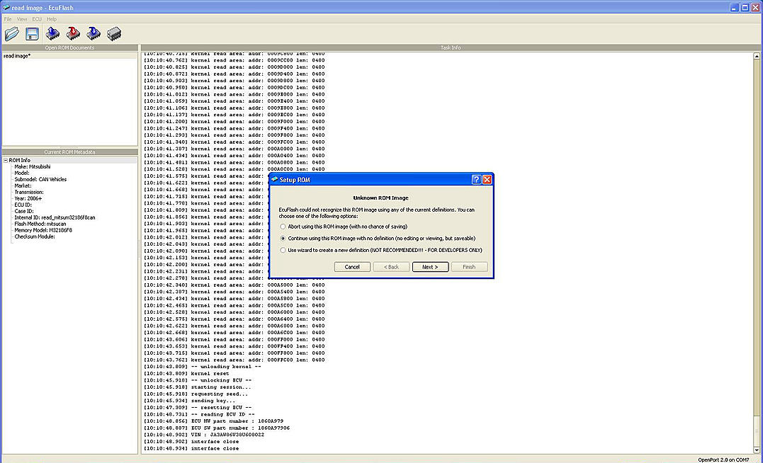

Hello fellow Evo'ers!
I have been troubleshooting issues on the Evo for approximately 6 weeks now, and haven't been able to get to the bottom of it. I am now setup on EcuFlash and am trying to read the rom so that I can do some logging. With a few logs, I'm figuring that some of you will have some opinions regarding what is going wrong.
See attached screenshot, I don't seem to be able to read and I'm pretty sure it's because I don't have the xml file needed for my car. I am using version 1.42.2595 on winxp, and my tuned rom is not locked. Does anyone have a definition file that would work with this vehicle?

Email me your ROM. I'll tell you what it is.

Got your files, I'll give them a run in the morning Golden. I'll keep you posted, thanks again!

I'm now able to read, thanks for the files Golden!
Considering that I'm full bolt-on w/ Kelford stg2 cams, if this is indeed a bone stock tune I can understand why I'm having issues! Mitsubishi probably flashed the car last time I was in. I've asked the original tuner to provide me with the tune file from last summer, I'll keep you posted.
