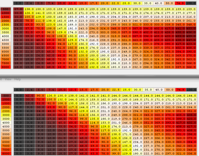

Hi friends. Can anybody ask me about this one. X and Y axis wrong yet.
Is it SSt torque limiters? Is it possible to disable ?
From evo10base.

mama says dont know dont touch and dont brick your ecu.
the tq limiters are there to protect the sst gearbox and the engine.
just my 2 cents

Ок. I am sure that Unknown Torque Limiter #1-3 = SST Torque Limiter #1-3.
If anybody want know SST Torque Limiter adresses for your ROm send me your hex and ordinary torque limiter adresses.

Do they look like the top or bottom of the attached?
- Bryan
- Bryan
Yes. But your scaled in enginetorque, mine in uint8.
http://photofile.ru/users/aik_evo/150589207/
Аnd i don't find X and Y axis yet.
