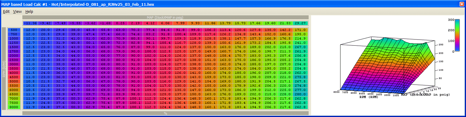

If this is one of the "3xMAP/MAF tables", it's (now) in my XML def...
The tables weren't in my xml, but were present in the file on your central storage site, Golden.
Additionally, I was missing MAF Scaling parts 1-3 - also sorted now.
Thanks a million for putting that resource together.
Rich

yeh, so look at the 21.53 column, you can see how Mitsu designed this table with various VE's of the stock motor/tune in mind.
change MIVEC and it all goes out the window - however luckily for us its not a big deal, we can just add/subtract more fuel from the table..
its also why timing doesn't seem to go up in the right amount, but rather taper off the higher the RPM..

So it looks like this says based on rpm and psi (boost) look to load cell "x" of that same rpm on the Fuel Table, as well as Timing.
