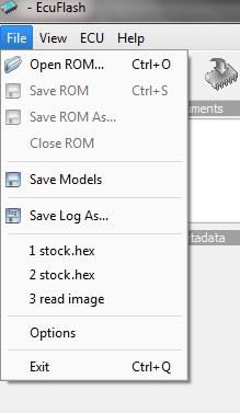

when i went to edit my metadata directory, it was the same as what I changed it to from the last install, not what it was default. also, when I clicked file, my stock hex was there, like I've opend it before, see pic.
and yes, it still crashed. I didn't put the right xml file in my metadata folder yet, so it couldn't open the rom file cause it didn't have the correct definitions. so it didn't open anything, but it still crashed a few minute later...
