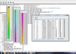

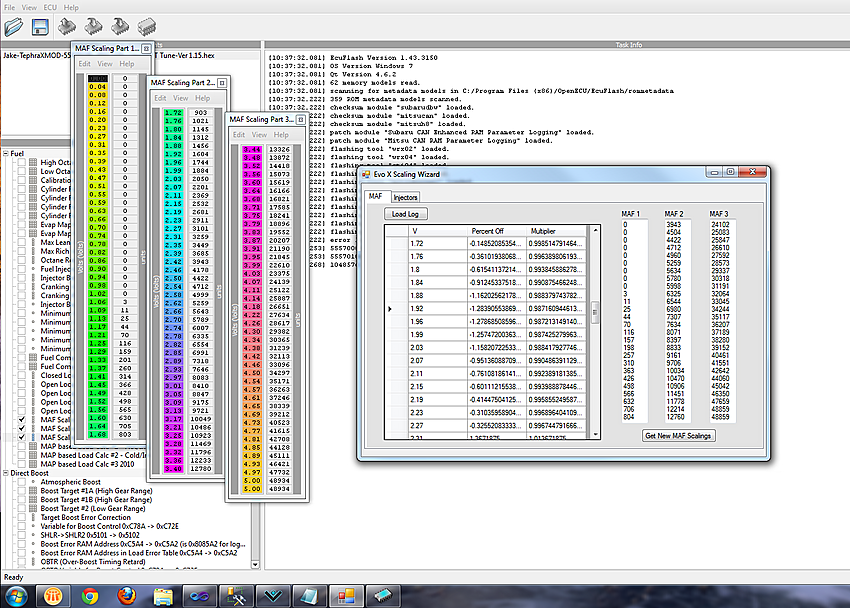

I've been wanting to make a nice GUI version to do this for awhile so I finally sat down for 2hrs and finished it.
It's a C#.NET desktop app so you will need to have the .NET client runtime installed on your machine. If you run Virtual Dyno you should already have this installed anyway.
Features:
  • Logs can be any size (limited by your computer RAM, really)
  • Log columns can be in any order
  • Log file should only have 3 columns total
  • Columns can have various names (program just looks for "maf", "stft", "ltft") in the header strings. Case insensitive
  • Allows you to copy / paste existing MAF scalings into 3 columns just like in EcuFlash
  • Will auto-multiply and give you your new scalings for easy paste back into EcuFlash
  • 18kb
Coming Soon:
  • Injector Scaler
  • Suggestions?
Feel free to test it out and report back. Enjoy!
File Type: zip

Yes, it's very similar to the web based php one swiftus made. I made this one because I needed an offline version I could use in the car without being on wifi. Also, I figured it could have a few improvements like the auto-multiplication of your MAF values.
