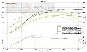

As for being very noticeable, A good chunk of that appears to be solely the tune from my perspective. Liek I mentioned my car is mostly stock and I'm sure you read that the stock tune is conservative as f*ck, I literally have only a tune and a bunch of parts sitting in my closet. I went the etune route early just cause there was a deal for $150 for an etune.
Just to give you an idea how much just the tune alone does:
Edit: As for the pro tune at a shop it varies, I typically see between $350 - $500. Installing varies as well, if you're getting a tune done there, I'm sure they'll cut you a pretty decent discount. My opinion just install it yourself. They're called bolt-ons for a reason, the hardest one will be the Downpipe from what I read, and even that there's 2 in-depth tutorials on this great site #brownnose.
