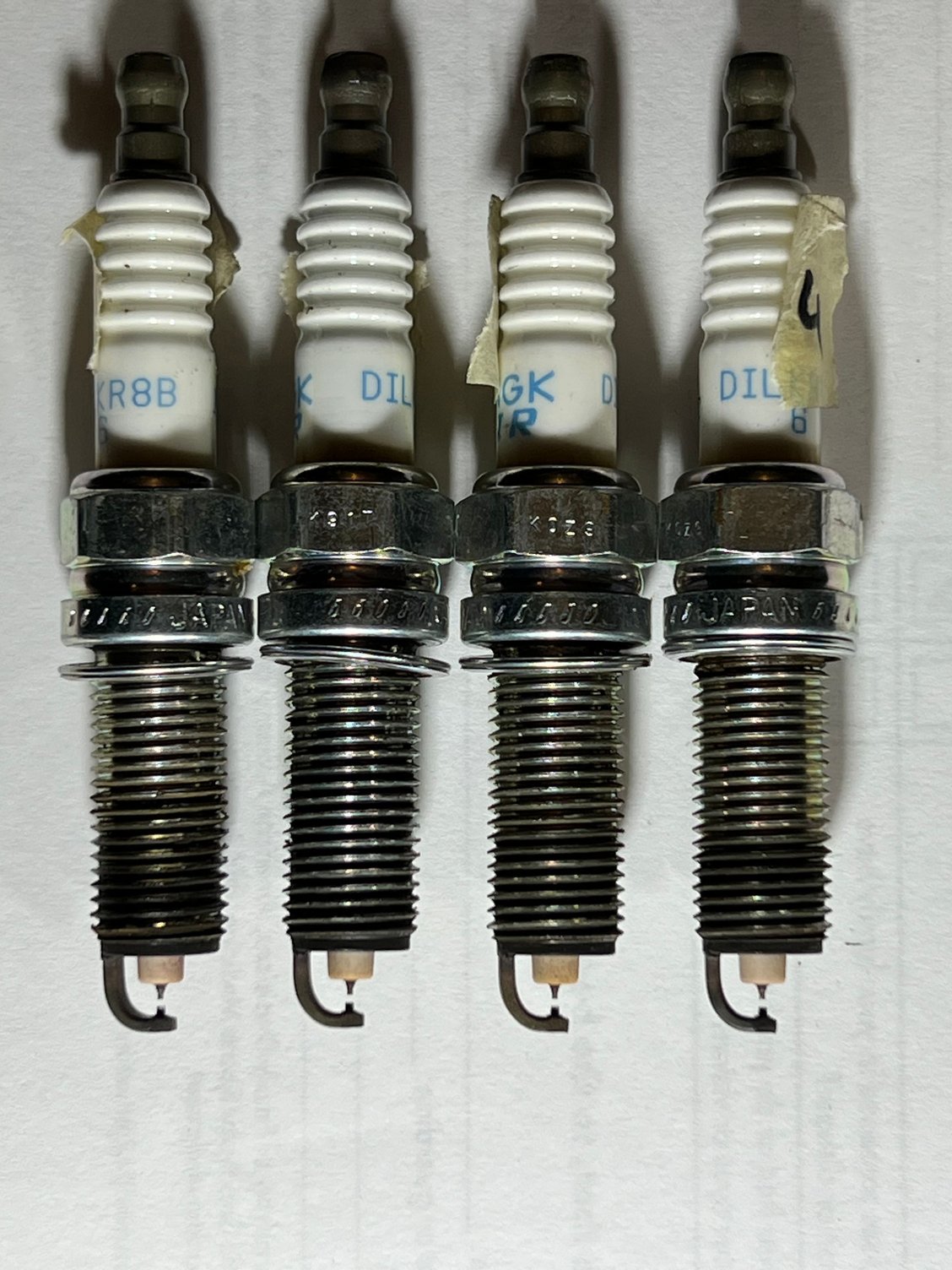

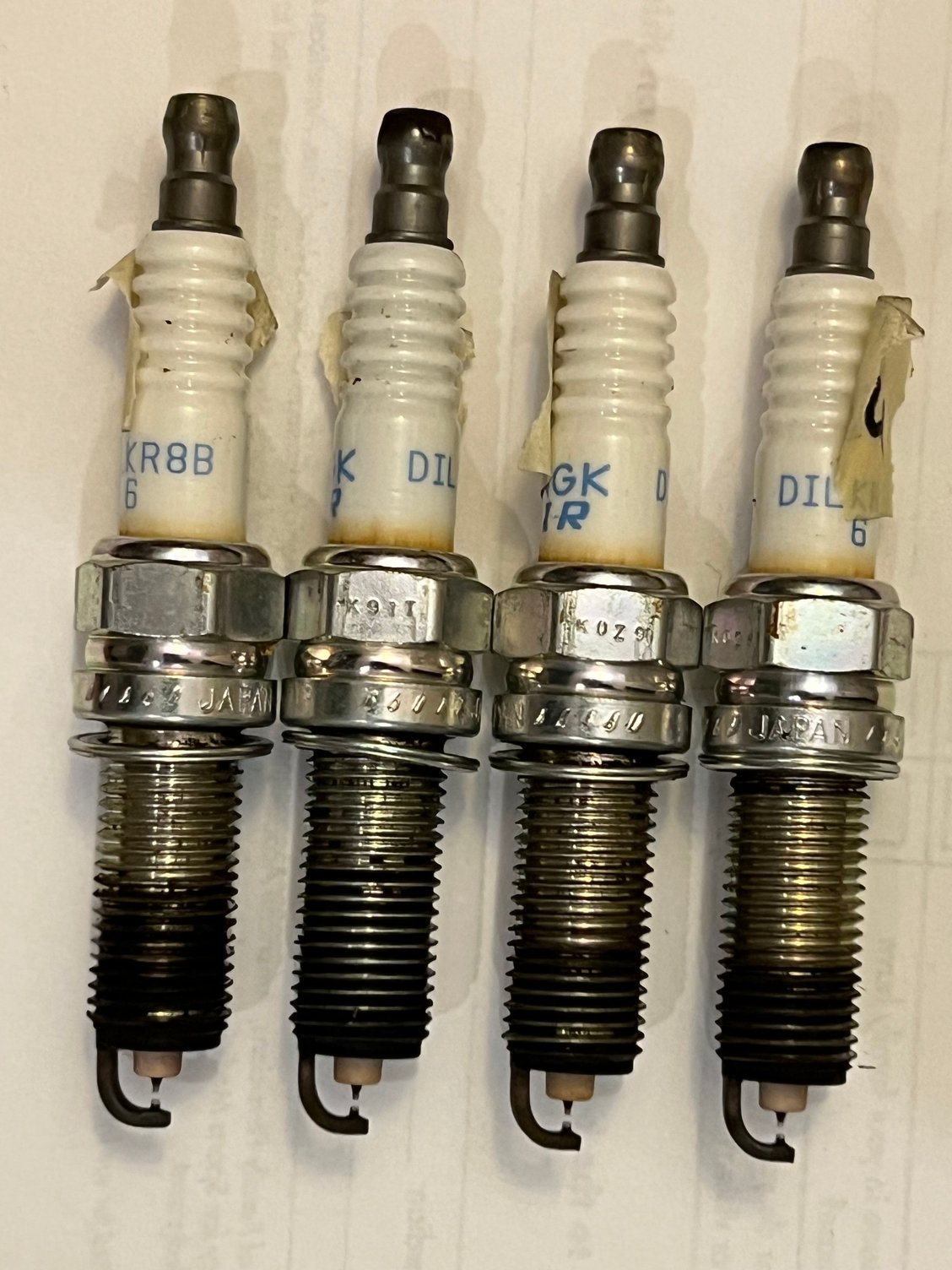

I would pull and check the plugs to get a sense of what was going on, are they in good shape, burnt up, etc.

I checked the spark plugs, they seem fine to me (attached).
