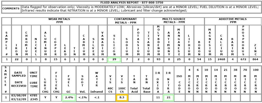

I updated the spreadsheet in my signature with my results. Here's a summary:
Break-in oil change @ 4611 mi.: Severity Level 3 (out of 4) silicon contamination. Could be from abrasives, seals and gasket material, lube additives, or environmental contaminants. Moderate levels of fuel dilution (2%) and viscosity degradation (8.2). The break-in period may be the reason for the high silicon levels given similar results in the rest of the spreadhsheet.
Second oil change @ 9617 mi. (5006 mi. on oil): Reduced silicon levels (25). Fuel dilution is Severity Level 4 (Critical, 4 out of 4) at 5%. Viscosity is significantly reduced to 7.3 for a Severity Level of 3. Fuel contamination is high enough that official report comments suggest beginning a search for a fuel leak (injectors, lines, etc.).
At around 9575 mi. I was turned away from our local dealership because "all oil smells like that." They refused to perform any work at all, and wanted $90 to change the oil so I had to go hunting for Mobil 1 to do it myself.
So, I'm not happy, to say the least...

I just performed my first oil chane at 1050 miles oil was black and did smell of gasoline. I changed with redline oil cuz i got a great deal on it. Car does feel a bit smoother but not considerably.
Results from my second oil change and sample. Numbers look almost identical to the first test, near same mileage on both samples. First test was at 2440 miles total sampling the outgoing factory fill. Second test is with 2345 miles on Mobil 1 5/30 (4785 miles total).
Most of the last sample period (>90%) was with a AP Stage 1 map installed.
From the first sample: wear metals dropped, silicon dropped, viscosity is slightly lower, the fuel dilution is identical and the additive packages are lower in the current sample.
